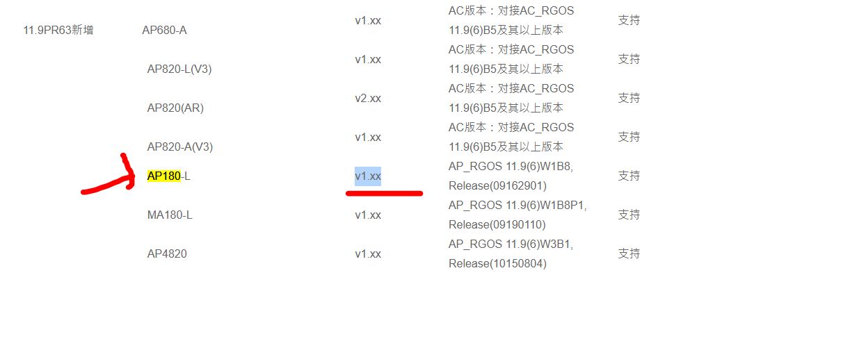

That is not supported by AP180-L

IT seems my AP180-L V2.0 is not yet support.
Can you help to ask your R&D release more APs model for Gateway based AC Management?
