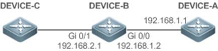

Scenario
Configuration Steps
DEVICE-A configures the local clock as the NTP reference clock source.
DEVICE-B configures DEVICE-A as the reference clock source.
DEVICE-C configures DEVICE-B as the reference clock source.
  DEVICE-A
  A#configure terminal
  A(config)# ntp master
  A(config)#exit
  DEVICE-B
  B#configure terminal
  B(config)# ntp server 192.168.1.1
  B(config)# exit
  DEVICE-C
  C#configure terminal
  C(config)# ntp server 192.168.2.1
  C(config)# exit
