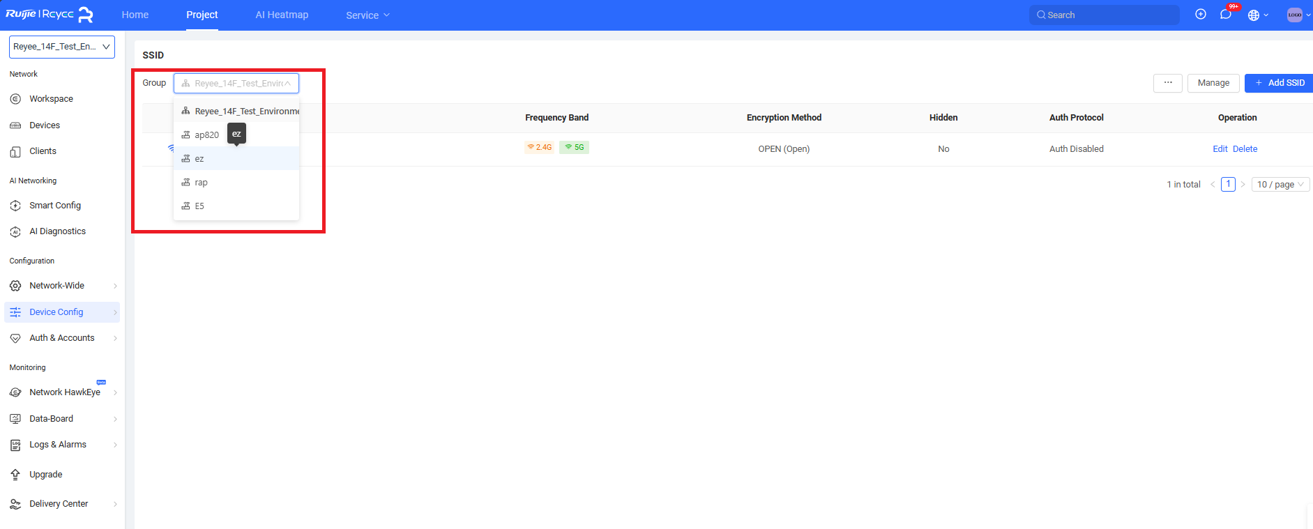

From your description, it is likely caused by the device groups settings. Could you check if the correct device group is selected in the SSID configuration page?

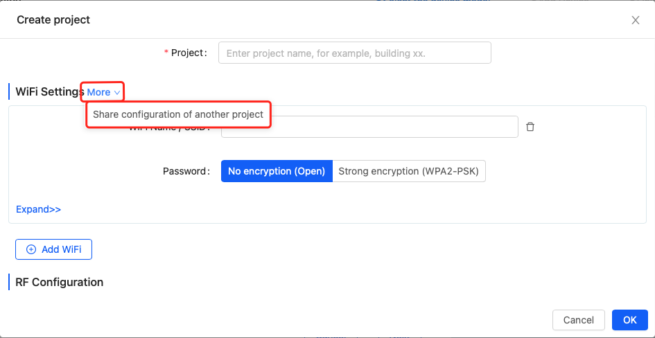

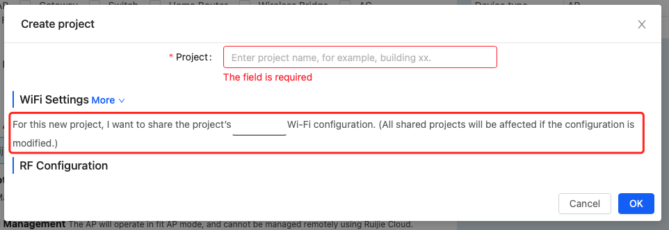

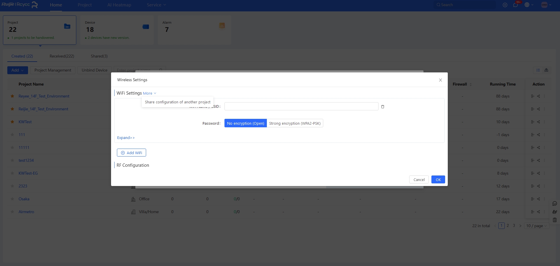

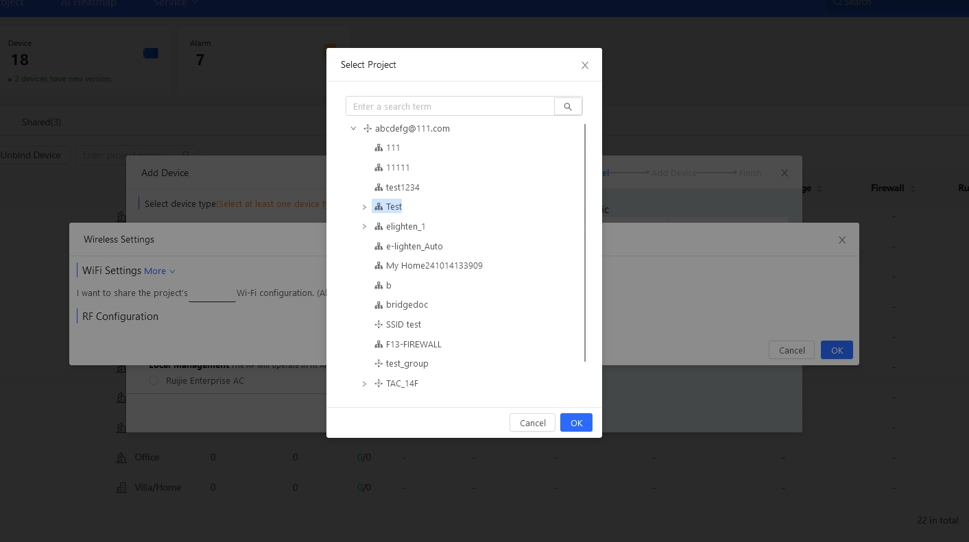

Hi, the issue may caused by this share configuration function, it appears when you add new project. it will share ssid configuration to another project.

I can't see the wireless settings window, I can't see it when creating a new project
0 2024-11-11 13:23:23 View all replies
Abdullah KIR replied at 2024-11-9 18:26
Dear Abdullah,
Good day.
You can see it here:
For your case we suggest you visit our live chat platform RITA so that our engineer can diagnose more specifically.
