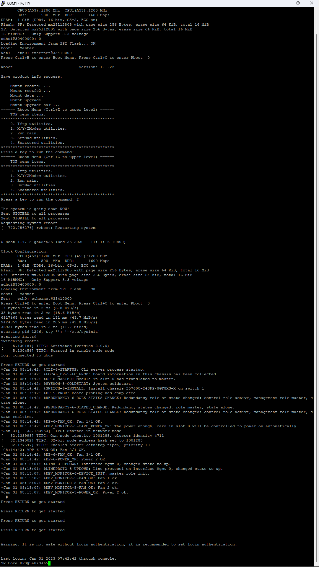

Tried Ctrl+Q but no response, any suggestions?
using S19_RGOS 11.4(1)B70P4

Could you help share me your operation log?
And you are press the ctrl +Q at the same time?

I flush the default environment at last, thanks

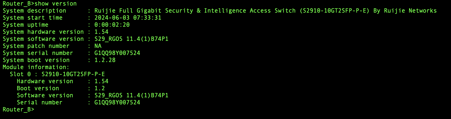

I have the same trouble, tried Ctrl+Q but no response, any suggestions?

Hello,
Can you take a screenshot to show me the current problem? After pressing ctrl+Q, does nothing happen? Or is it going to produce some kind of log?

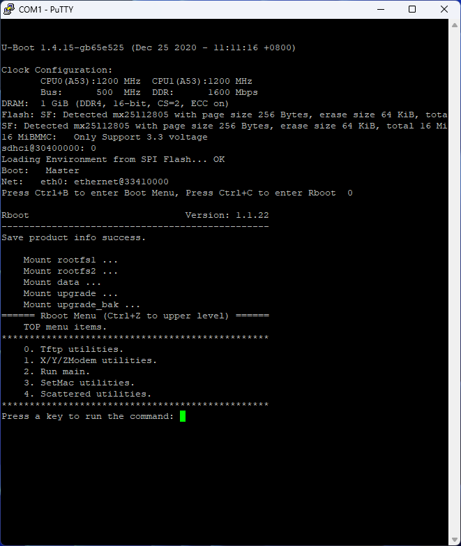

Thank you for your response Mica,
My trouble is if I use terminal on my Macbook, I try to use putty on Windows operating system and running well.

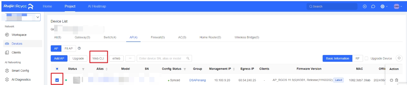

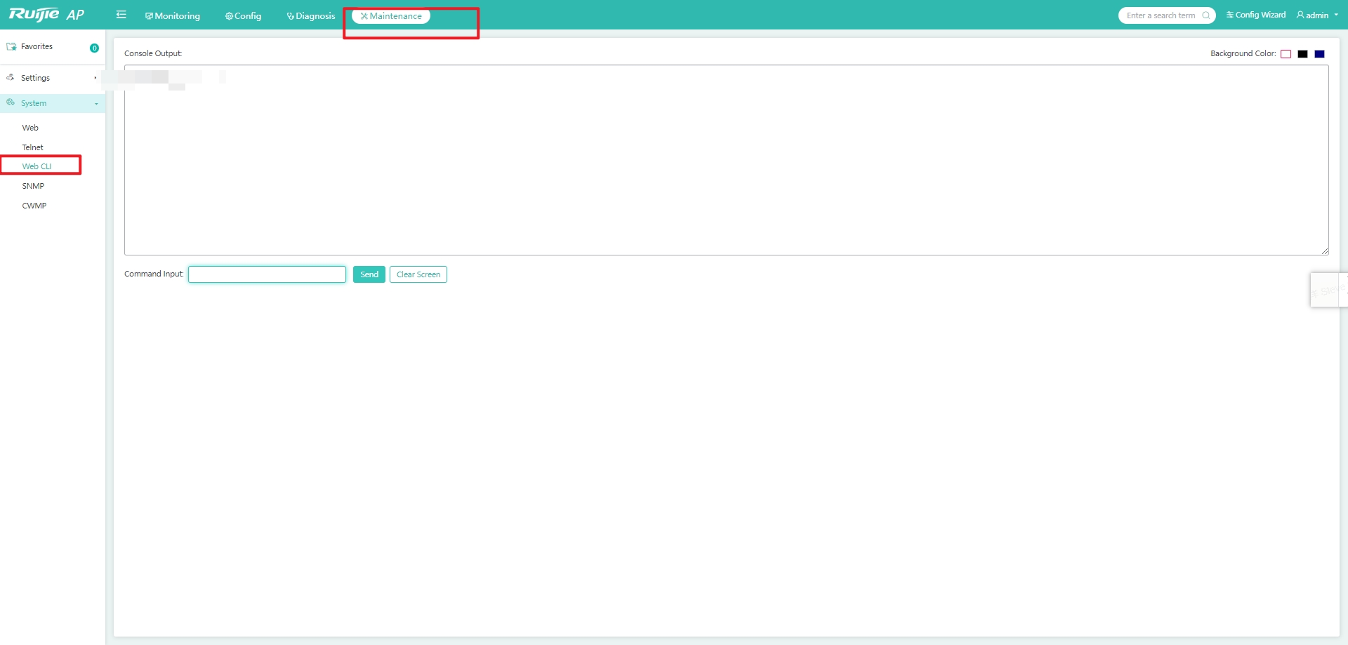

Hi sir,
Yes, it can support.
1.you can use telnet to configure this command.
2. If your AP doesn't have telnet configuration, you can try using web cli from cloud.
3. You can configure it via eweb
