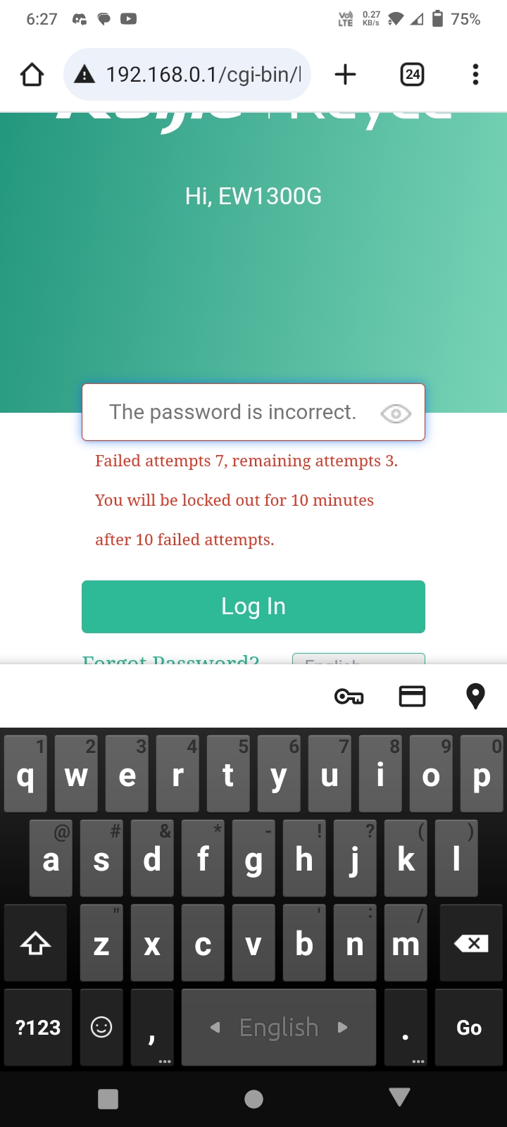

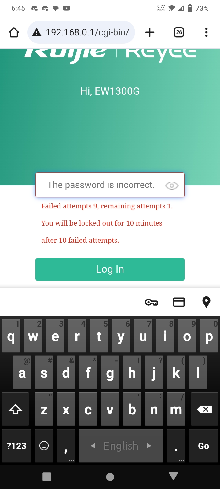

How to do it with mobile
0 2024-7-27 18:31:07 View all replies
How we reset with mobile
0 2024-7-27 18:32:05 View all replies
User 98435 replied at 2024-7-27 18:29
The commands should be applied to AP CLI. You need to connect to AP CLI by a console cable, or use telnet or ssh. Sorry it cannot be done with mobile phones.

0 2025-5-18 22:51:04 View all replies
0 2025-5-18 22:52:28 View all replies
help me please
