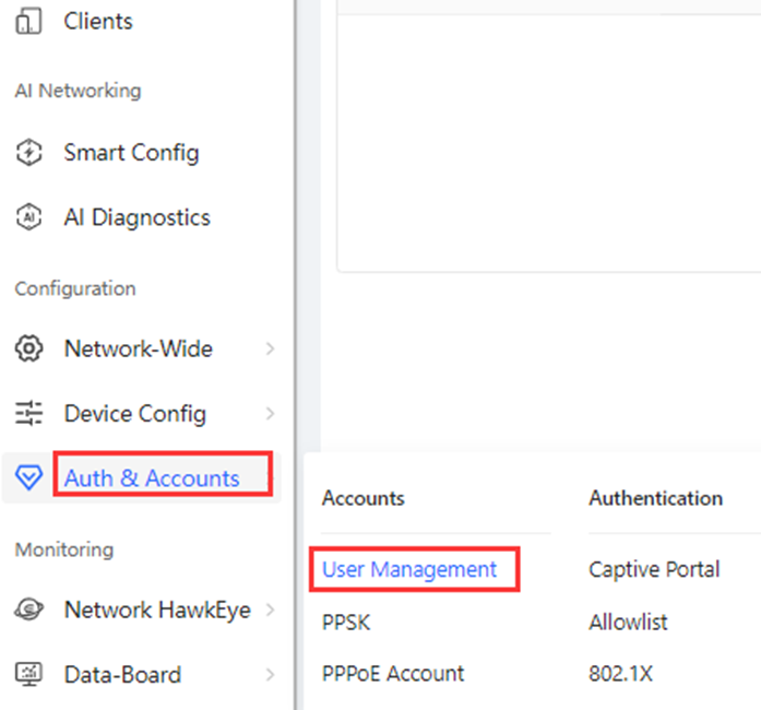

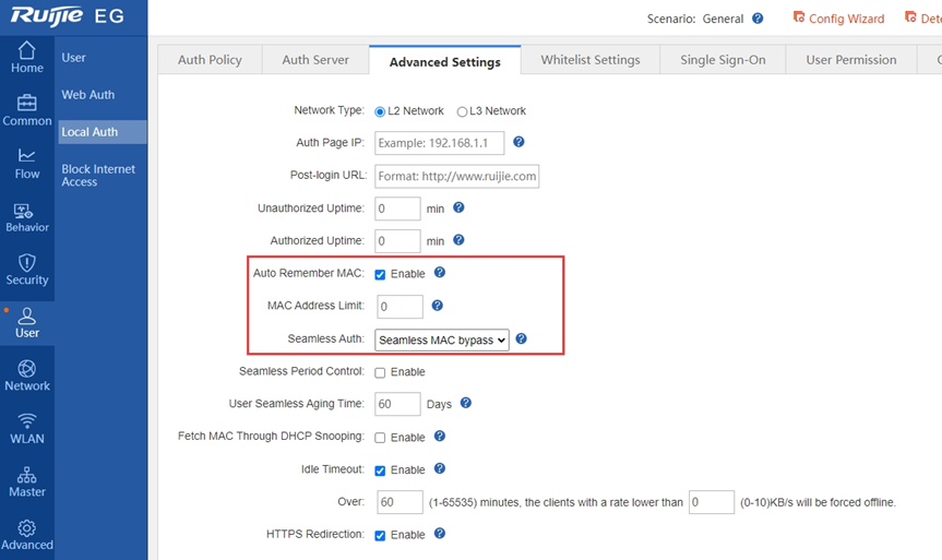

1. Configure MAC access limit with 0
2.

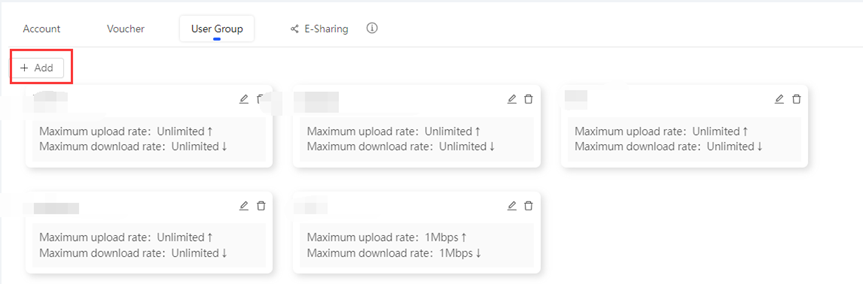

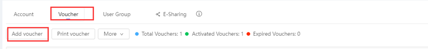

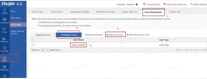

Create a Voucher code on the Cloud and add it to the Privileged Group

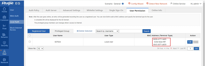

3.Then test whether there are multiple devices connected to the network with the same voucher code
