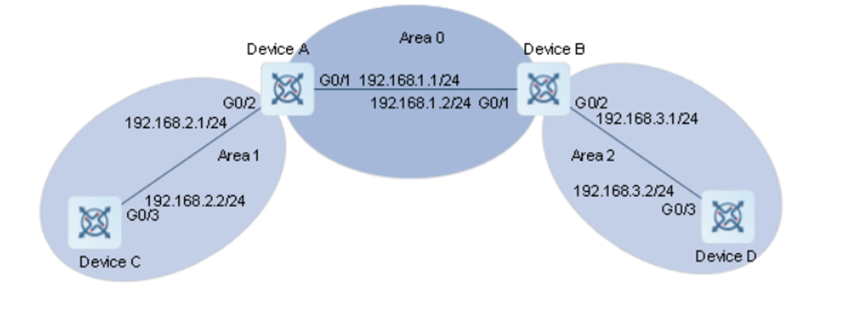

Topology:
Make all networks interoperable
Configurationsteps:
1. Configure the Interface IP Address on all devices.

2. Configure the OSPF instance, Router ID, and add the interface address to OSPF
#Device A's configuration.
DeviceA (config) #router ospf 1
DeviceA (config-router) #router-id 192.168.1.1
DeviceA (config-router) #network 192.168.1.0 0.0.0.255 area 0
DeviceA (config-router) #network 192.168.2.0 0.0.0.255 area 1
#Device B configuration.
DeviceB (config) #router ospf 1
DeviceB (config-router) #router-id 192.168.1.2
DeviceB (config-router) #network 192.168.1.0 0.0.0.255 area 0
DeviceB (config-router) #network 192.168.3.0 0.0.0.255 area 2
#Device C configuration.
DeviceC (config) #router ospf 1
DeviceC (config-router) #router-id 192.168.2.2
DeviceC (config-router) #network 192.168.2.0 0.0.0.255 area 1
#Device D configuration.
DeviceD (config) #router ospf 1
DeviceD (config-router) #router-id 192.168.3.2
DeviceD (config-router) #network 192.168.3.0 0.0.0.255 area 2
