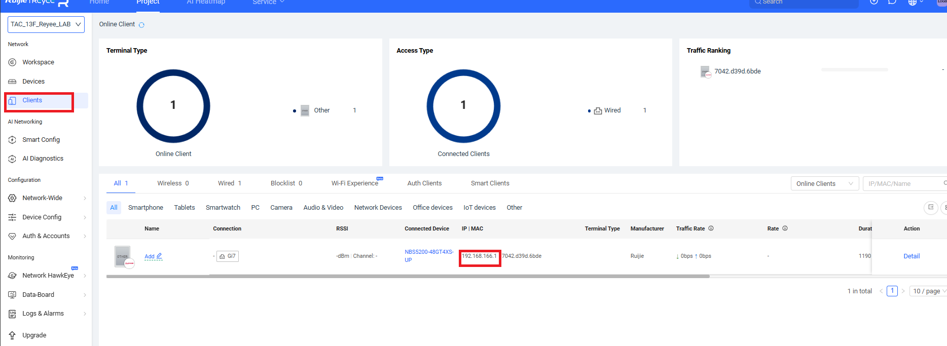

When the issue happens, could you check if the camera is still in the client list?

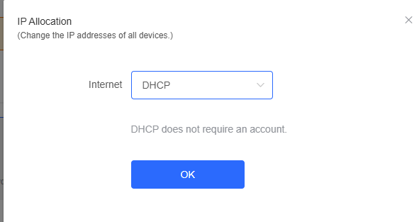

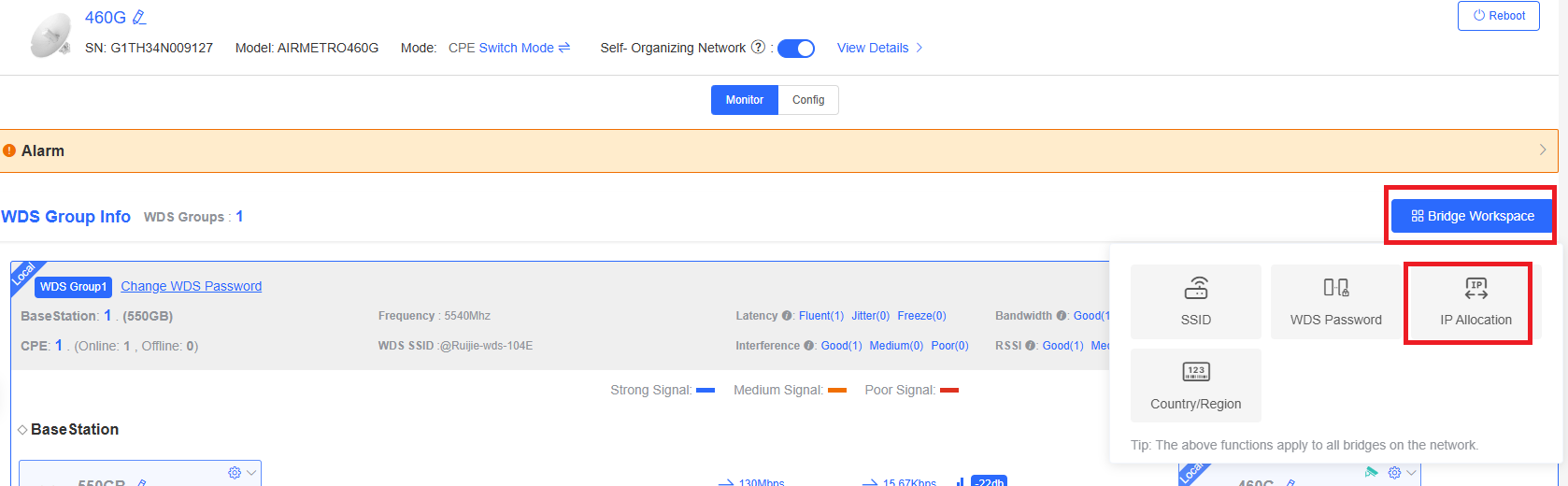

If the camera is still in the client list but without an IP, it could be that the camera fails to aqcuire one due to IP conflict. In this case, you can check the IP allocation settings in your CPE unit and set it to DHCP so the camera can acquire an IP from your router.
