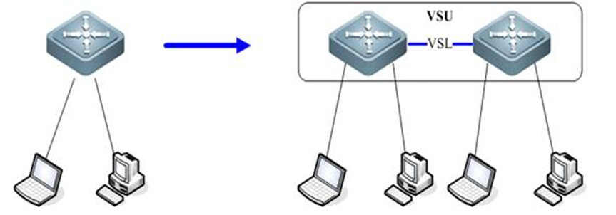

VSU is a technology that virtualizes multiple devices into one device to manage and use, which can significantly reduce management complexity and topology logic complexity. VSUs are usually connected to peripheral devices using aggregation ports, which can effectively utilize redundant links while improving the forwarding capacity of the system.
