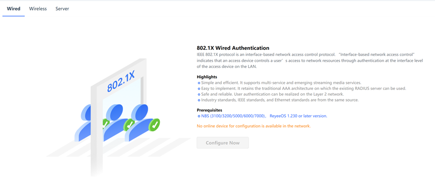

We all know that it's easy to deploy wired 802.1X authentication for NBS series switches. You can simply configure it in our Ruijie Cloud management page, but Cloud doesn't support configuring RGOS switches.
Let's find out how to configure wiredauthentication for RGOS switches!
It's pretty simple and straight forward to configure wired 802.1X authentication using NBS switch withReyeeOS.

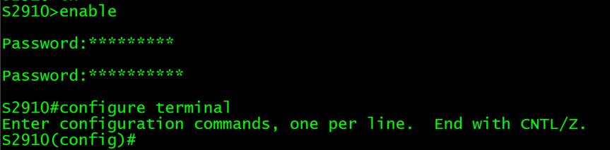

1.After entering command line interface, type enable to enter privillege mode, then type configuration terminal to enter configuring mode.

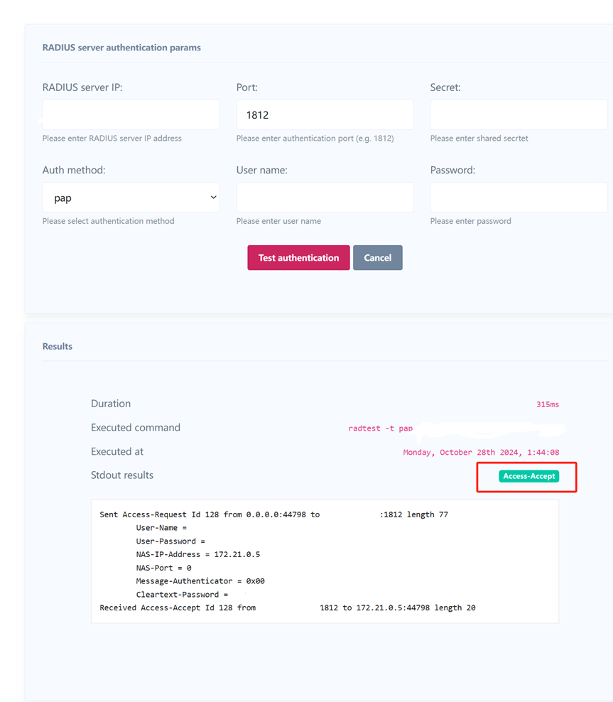

2.Make sure your RADIUS server is reachable. You canuse a command-line tool for checking connectivity.
If your server is accessible though the Internet, you can try an online RADIUS test tool like the link below.
https://idblender.com/tools/test-radius#087d9867-d426-499d-a5e1-fd490909f60b
If Stdout results show Access-Accept, that indicates your RADIUS server is running normally.
For RADIUS server in local network scenario, you can use radtest -t pap USERNAME PASSWORD' RADIUS-Server-IP:1812' 0 SECRET.
Its output should be like:
  SQL
Sent  Access-Request Id 172 from 0.0.0.0:54087 to RADIUS-Server-IP: 1812 length 77
          User-Name =  "USERNAME"
          User-Password =  "PASSWORD"
          NAS-IP-Address = 172.21.0.5
          NAS-Port = 0
          Message-Authenticator = 0x00
          Cleartext-Password =  "SECRET"
  Received Access-Accept  Id 172 from RADIUS-Server-IP:1812  to 172.21.0.5:54087 length 20
Also, Access-Accept indicates your RADIUS server i srunning normally.

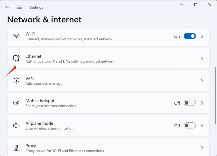

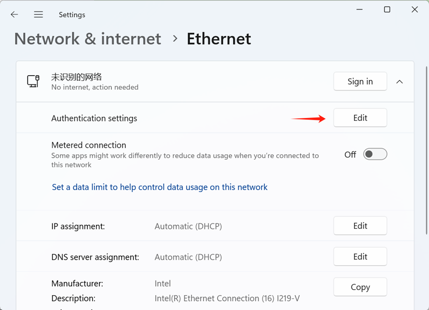

After configuring that, you can plugged the switch'sGi0/20 port with the Windows laptop, let's try if it can work.
Enter Ethernet setting page of Windows 11
You can see a prompt here,click Edit

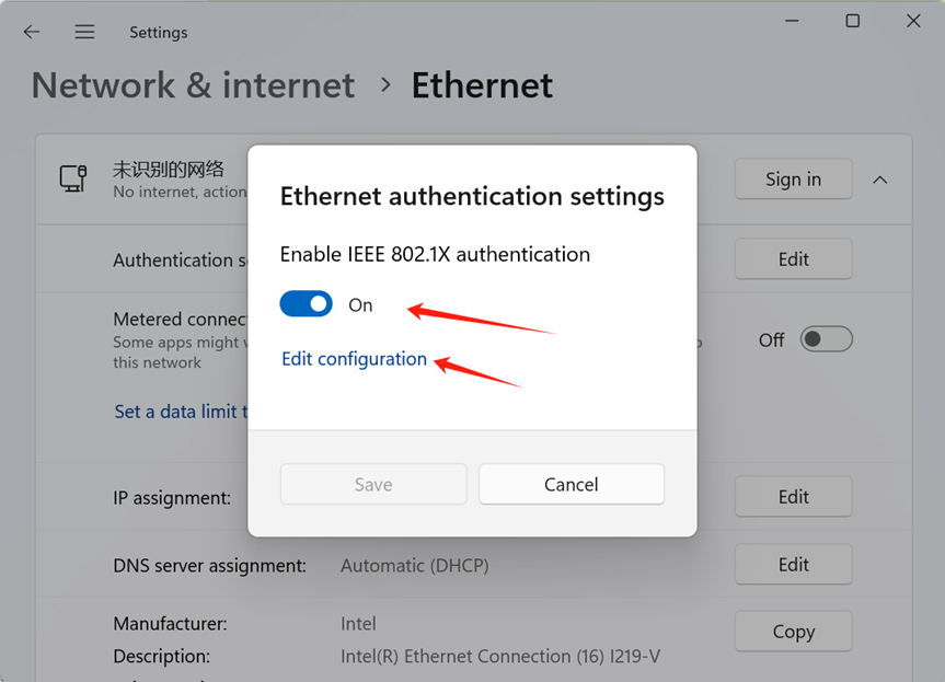

Enable IEEE802.1X authentication, then edit configuration

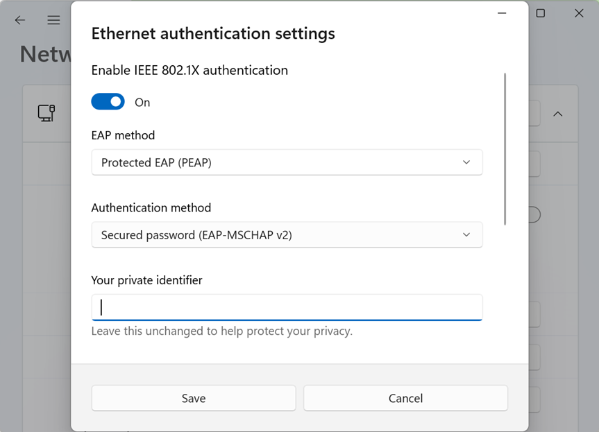

Choose authentication method
EAP method: Protected EAP (PEAP)
Authentication method: Secure password (EAP-MACHAPv2)

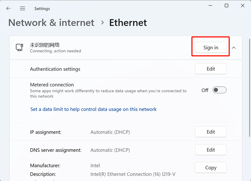

After done that, click Sign in
After entering the username and password of your RADIUS server, you are able to use your network then.
