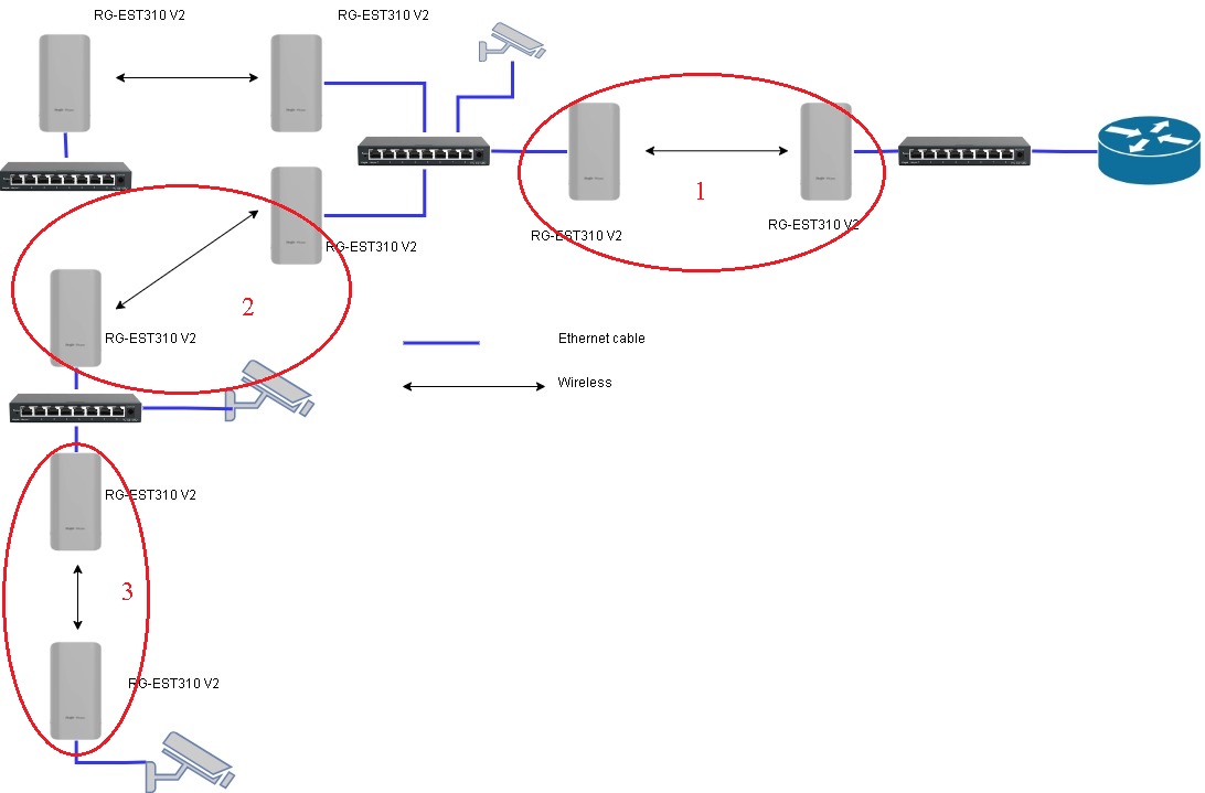

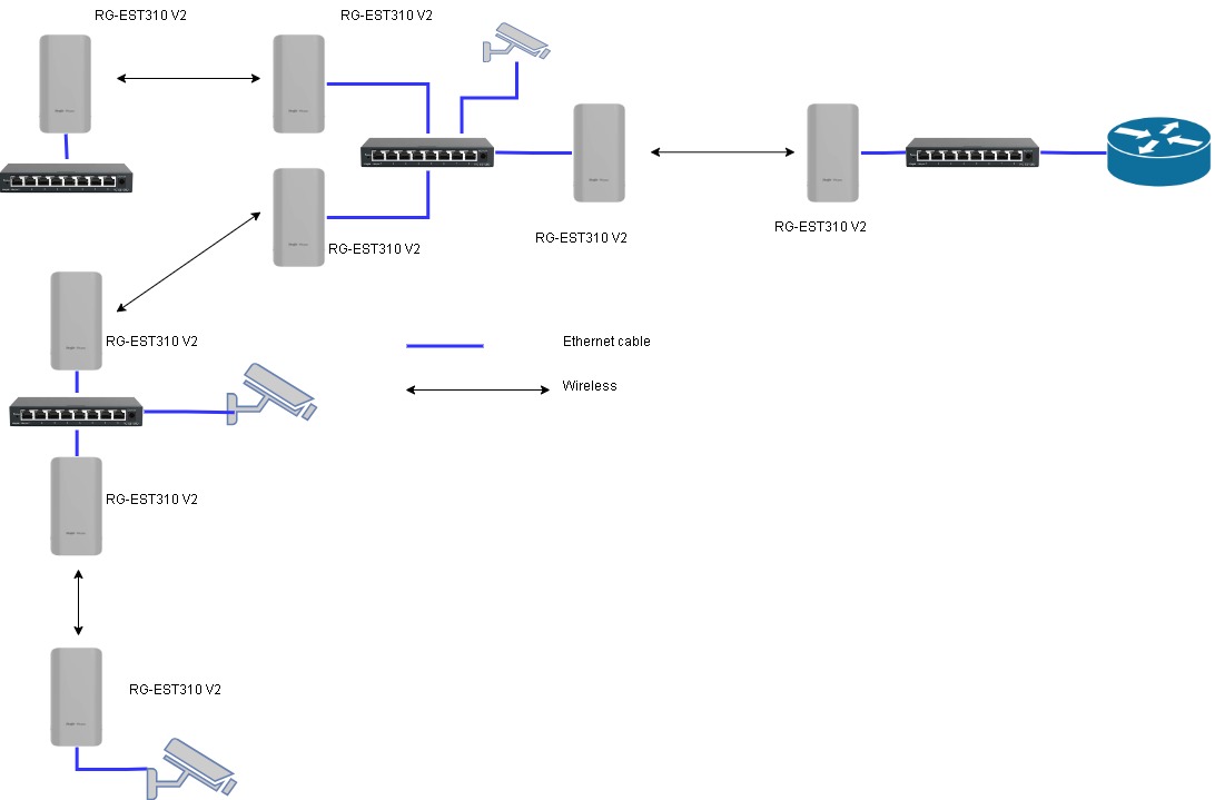

Dear Ruijie team,
I have some pairs of RG-EST310 V2 and I want to use as below diagram. Please advise if it is doable. Thanks,
RG-EST310 V2
Wireless-Bridge
0 2024-12-28 13:49:14 View all replies
Hello,
Topo link EST1-EST2-SW-EST3-EST4 is support . But pls not less than 3 hops is recommended.

Thank you Micca, I case we have more than 3 hops, do we have solutions?
0 2024-12-28 16:11:54 View all replies
Phung Hoang replied at 2024-12-28 16:07
Hello,
As we suggested earlier. This is not feasible. Eventually, device may lose access to the Internet. This is the limitation of the device.
Micca
0 2024-12-28 16:25:05 View all replies
GTAC-Micca replied at 2024-12-28 16:11
Hello,
As we suggested earlier. This is not feasible. Eventually, device may lose access to the I ...
So let's go back to the diagram, the link marked 1, 2, and 3 is considered as 3 hops? and must not exceed 3 hops?
Thanks,
0 2024-12-28 16:36:05 View all replies
Phung Hoang replied at 2024-12-28 16:25
So let's go back to the diagram, the link marked 1, 2, and 3 is considered as 3 hops? and must not ...
Hello,
Your diagram is correct. Your understanding is also correct.
Micca
0 2024-12-30 19:39:43 View all replies
GTAC-Micca replied at 2024-12-28 16:36
Hello,

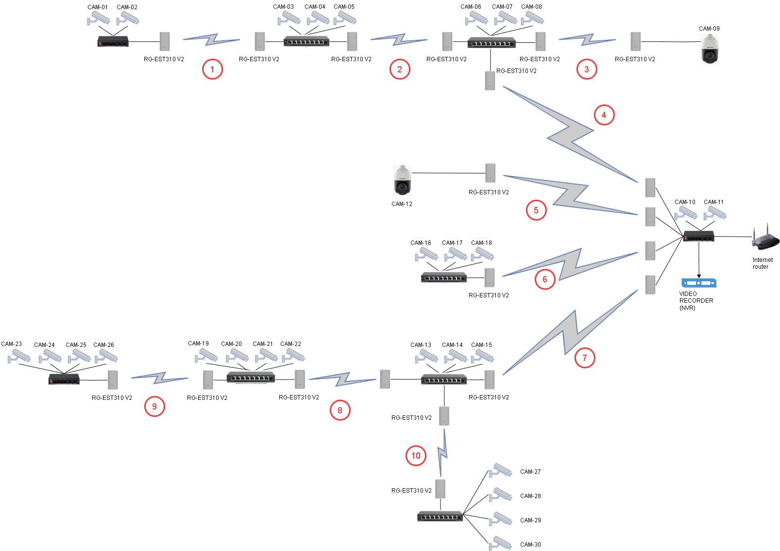

Thank you Micca,
Today, We did site survey and due to some obstacles (tree leaves, branhes that block the signal - I was advised that this need to be light of sight) even the maximum distance is 200m. I have proposed diagram below. Please kindly advise if it works. We have totally 30 cameras.
Thanks
0 2024-12-31 11:08:37 View all replies
Phung Hoang replied at 2024-12-30 19:39
Thank you Micca,
Today, We did site survey and due to some obstacles (tree leaves, branhes that b ...
Hi Micca, can you please check and advise?

Hello,
Can you explain to me what the numbers on the picture mean?
Also, have you verified the compatibility of your switch model with the camera?
Hi Micca, the numbers marked are number of wireless bridge pair only. For the switch, we used ruijie rg-es108gd, rg-es210gs-p and dahua poe dh-pfs3006-4et-60 for camera.
0 2024-12-31 15:18:34 View all replies
Phung Hoang replied at 2024-12-31 13:58
Hi Micca, the numbers marked are number of wireless bridge pair only. For the switch, we used ruij ...
Hi sir,
Is this the project deployment phase? If so, may you send your detail demand, In order to protect your privacy security, please sent to service_rj@ruijienetworks.com.
Steve
0 2025-1-2 10:42:39 View all replies
