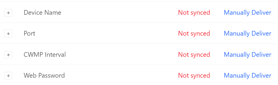

I have manually delivered the "not synced" items, but still doesn't show up as online.

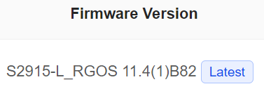

Also checked it is running the lastest firmware version.

H iCan you connect to the console port and enter the following command?
Ruijie#config ter
Ruijie(config)#cwmp
Ruijie(config-cwmp)#url acs https://cwmpsvr-eu.ruijienetworks.com/service/acs/XXXXXXXXXXXXX
Ruijie(config-cwmp)#end
Ruijie#wr
where, eu in bold means the cloud server you are logged in to when logging into your ruijie cloud account. You can check it in your URL.If your server is cloud-me, cloud-la or cloud-eu, please use eu.
If your server is cloud-as, please change eu to as.On the other hand, replace XXXXXXXXXXXXXX with your device's SN.Regards,
