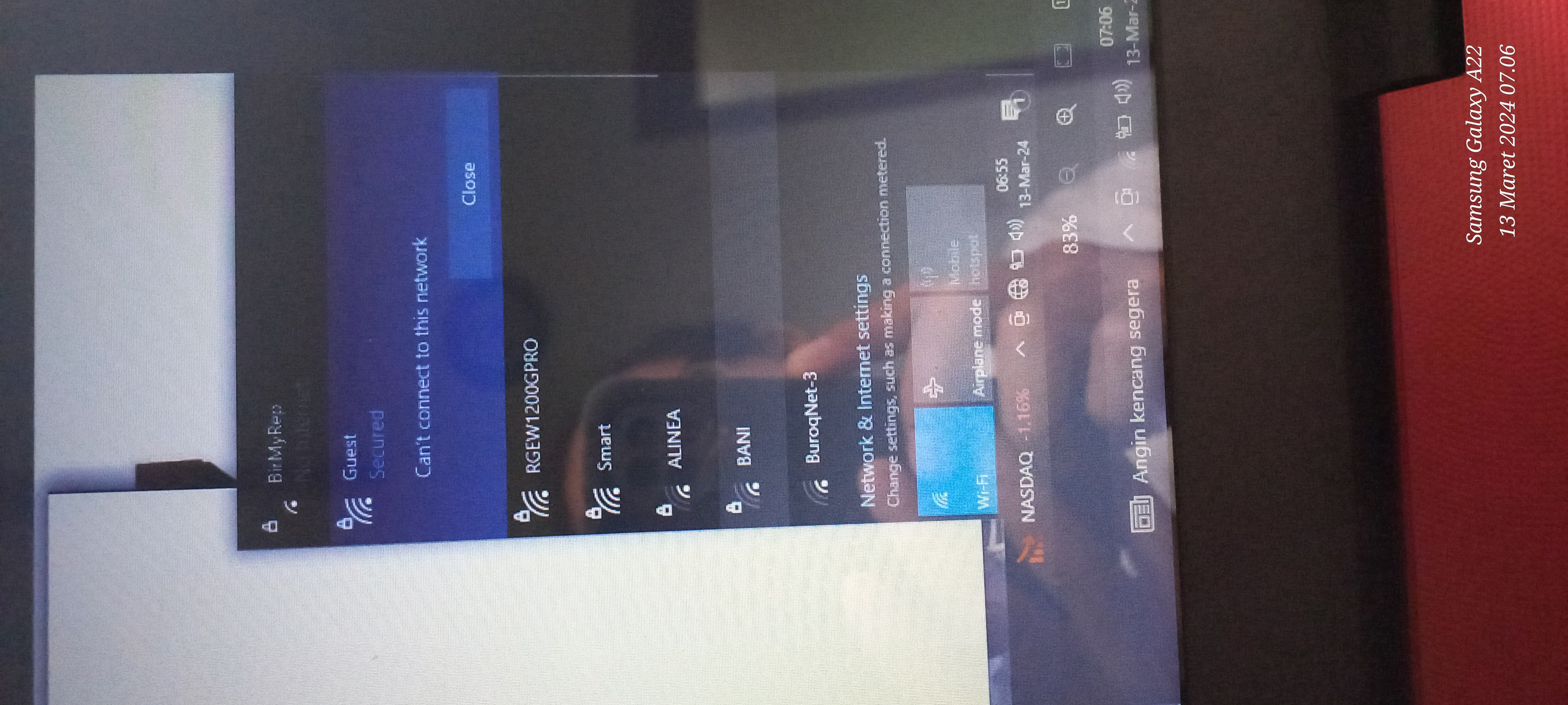

the problem is when I set using Access point in my handphone and setting guest wifi with dual band but unfortunately, my laptop can't connect to guest WIfi (With correct password).
Please advice on these, Thanks

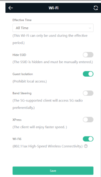

2.May you show me this configuration? If you enable wifi6, please disable then test it.

Thanks for the reply, as per your request, please find on the attchment that view of guest wifi still can't connect even the the range between my computer and Wifi rujiee is  50 cm only, so I think that no problem about range. For comparing also, I use router ISP (fiber home brand) and direct connect using wifi that so far no problem even range more than 10 m.
please more advice why this happen only used the laptop can't connect wifi?

Hi sir,
could you please show me guest wifi configuration on RG-EW1200G PRO?
