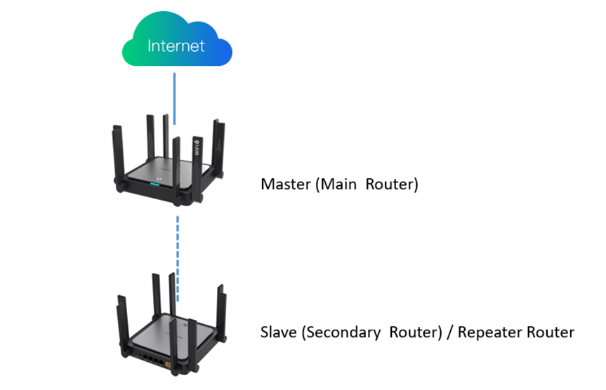

Network Topology

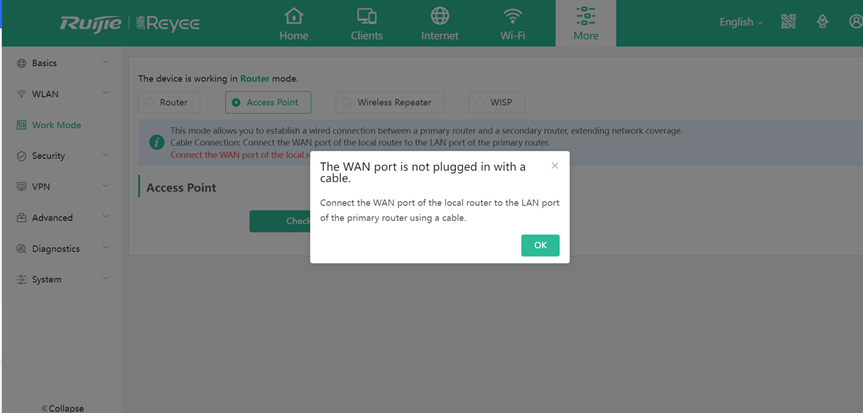

1. Check whether the ports are connected correctly. The WAN port repeater router shouldconnects with the LAN ports of main router.
A error will be reported if the WAN port is notplugged in with a cable.

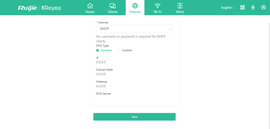

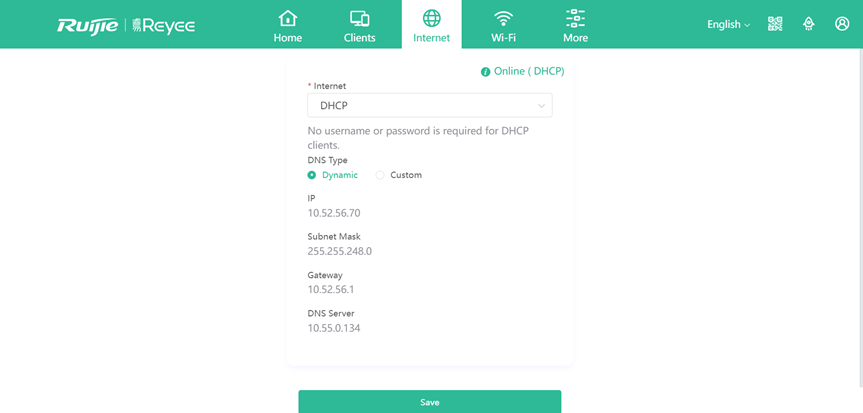

2. Check whether the EW router can get IP address from DHCP. If it’s failed, please check the DHCP configurations of the DHCP server. And connecting the LAN port of main router with your PC to check whether the PC can get the IP address.
Fail to get IP address:
Get the IP address successfully:
