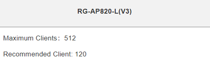

What is the difference between Max Client and Recommended Client? Reply
5277 0 2023-3-28 20:47:24
The recommended refers to the maximum number ofclients that can be connected to the current network and ensure normal running.
Concurrent clients refers to the maximum number ofaccesses, which is usually tested in the lab during the development of theproduct.
512 is the Concurrent Clients, that means there are512 clients that can connect to this AP at the same time (MAX)
but for 120 recommended number, we can ensure that all these 120 clients can use this network and access the internet without interruptions (MAX number of accesses with the best performance)
