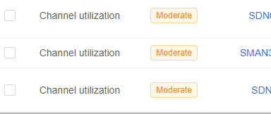

I got warnings / alarms about channel utilization. What does it mean and how to handle it ?

That just means the channels you are using are somewhat overloaded.
Could be your own wifi capacity is not enough or somebody else is using the same channels.
You can try firing up the WIFI Optimization. If that does not help you can set different channels manually.
Additionally check if you have many users on the same channel/radio. I´d suggest not more than maybe 30-50 on the same AP (depending on your usage).
If you figured your capacity is too low and you have too much load on your own, you can try to raise the channel-width (only on 5ghz) as a stop-gap solution and add more APs later.

I am experiencing the same thing which is Channel Utilization Alarm, what is the solution?

forgot about it or ignore it that alarm..
the root cause is congested in same channel that cause by your own AP and 3 or more users
or
cause by many AP's in the same spot (like your neighbour)
base in my project...
that alarm not ready yet..
