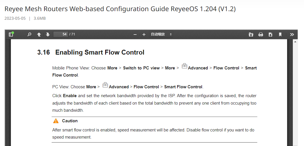

Does the Ruijie RG EW1200 support bandwidth control settings and how?

You can refer to this link to configure flow control on the EW1200
https://www.ruijienetworks.com/resources/preview/Web-based-Configuration-Guide-ReyeeOS-1204
0 2024-2-26 19:09:22 View all replies
GTAC-Ross replied at 2024-2-26 19:02

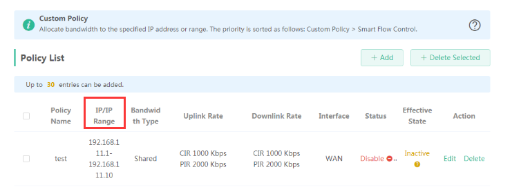

Thank you for your reply, that's for setting the overall bandwidth limit, how do you do it to set the bandwidth per device?

On the flow control
you can see  there is custom policy
in that case, we can set up flow control based on the single device by one ip address or
configure flow control based on the ip range for mutiple devices

Oke, many thanks
