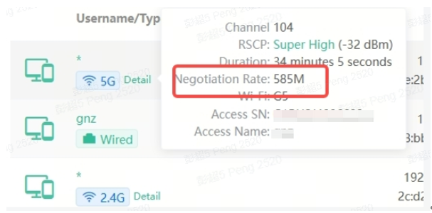

1. Slow data forwarding rate caused by low wireless negotiation rate.
Wireless negotiation rate is the speed negotiated by the terminal and AP according to the signal strength,interference, network card capability, etc. In the case of a good wirelessenvironment, the actual wireless forwarding rate is generally 50%-60% of thenegotiated rate, for example, the negotiated rate is 300M, and the actualforwarding rate is about 150M-180M. Therefore, if the wireless negotiation rateis low, the data forwarding rate is also low. You can check the wireless negotiationrate in the following ways:

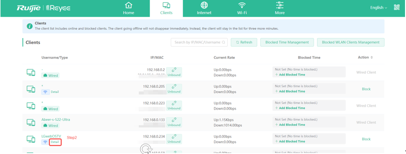

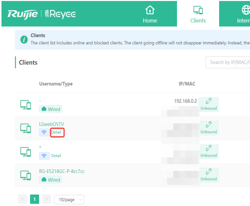

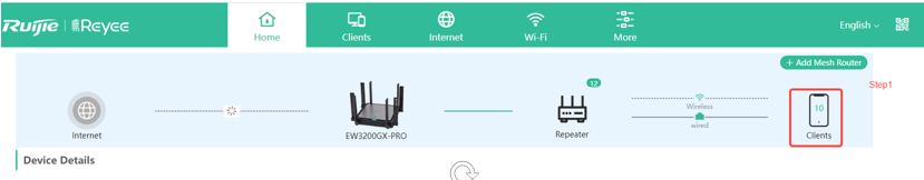

(1) Check it on router

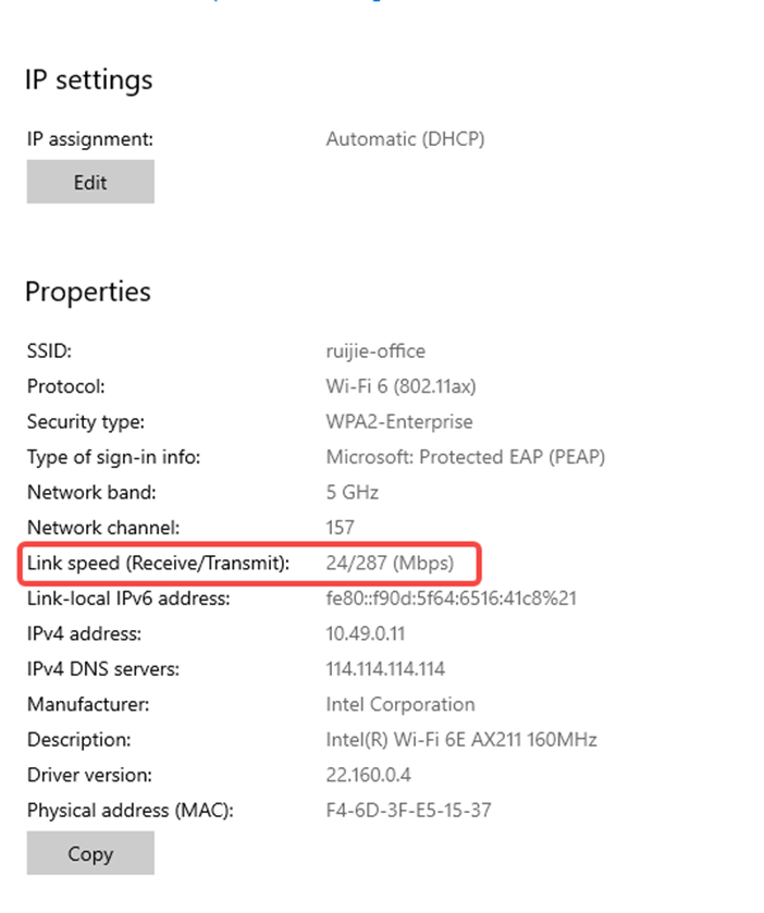

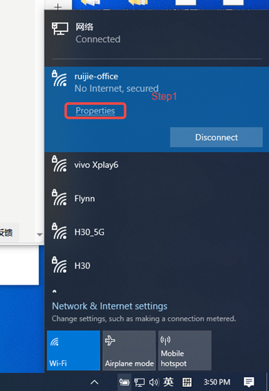

(2) Check it on computer:

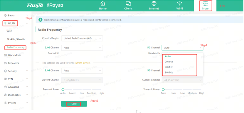

(1) Channel bandwidth is to small
Small bandwidth causes low negotiation rate, while large bandwidth causes heavy interference. It’s recommended to set the 2.4Gbandwidth as 20MHz and 5G as 40MHz. If you want the test the device performance,please set the 5G bandwidth as 80MHz.  The settings are as followed:

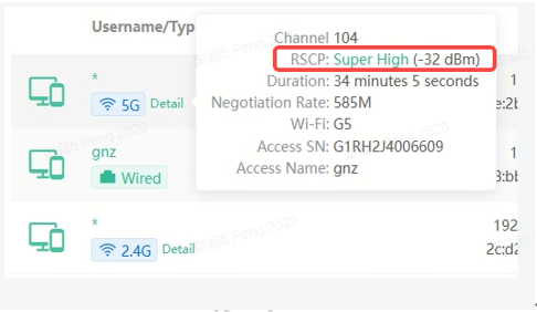

It would be better if the wireless signal strength is above -65dbm.if you want to carry out the equipment limit performance test, the strength isrecommended at about -45dBm. You can view the wireless signal strength in thefollowing way:
If the signal strength is weak, please do as followed:
