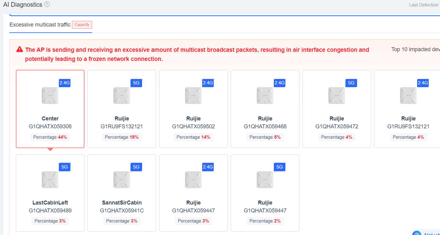

Please provide the solution for this issue Reply
Rinku Singh
1150 1 2024-10-9 17:22:48
RG-RAP2200(E)
0 2024-10-10 00:01:45 View all replies
Dear Singh,
For models that does not support multi-cast/broadcast suppression like RG-RAP2200(E), the only way to resolve it is to create vlans to segment your network, so the broadcast packets can be limited to certain range
You may refer to the following guide on how to do it.
https://cloud.ruijienetworks.com/help/#/ArticleList?id=e08f0441c8d54aa68011d1aa7338a5a7
