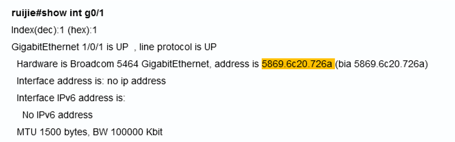

For Ruijie AP:
The AP interface MAC is the MAC address used to identify the interface, which can be configured and changed. In general, the device's system MAC is reduced by 1 for the interface MAC. You can also use this command to check the AP specific interface MAC address: show int gx/y

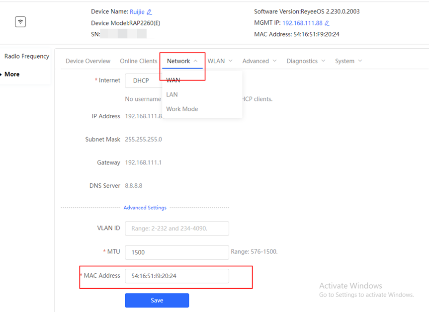

For Reyee AP:
You can check the Reyee AP interface MAC address on the device back panel or on the device's eweb home page here:
