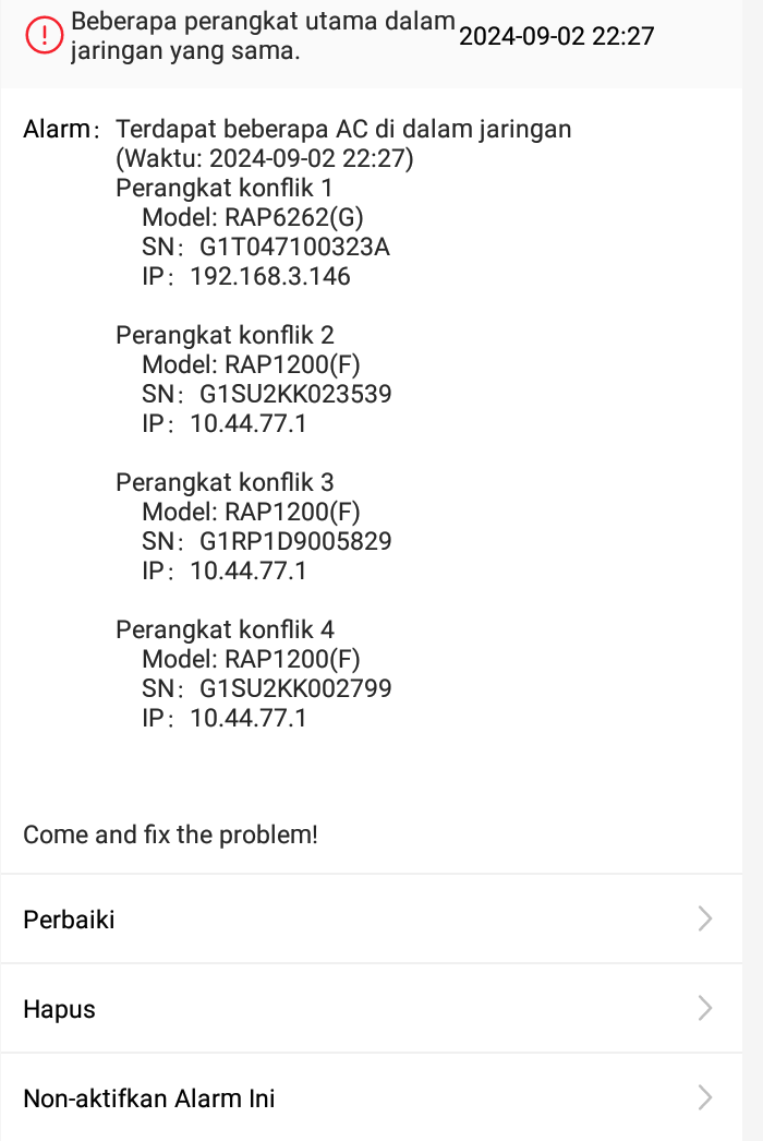

ac conflik, bagaimana cara memperbaikinya Reply
muhammad haris
1418 4 2024-9-3 08:28:28
RG-RAP1200(F)
0 2024-9-3 13:24:28 View all replies
May I know whether the RAPs are connected to the same network actually, can they access with each other?
Please make sure that the devices are in the same network, so that they can elect a SON master normally and manage the rest of devices in the same network.
Jenny
0 2024-9-3 21:45:05 View all replies
GTAC-Jenny replied at 2024-9-3 13:24
May I know whether the RAPs are connected to the same network actually, can they access wi ...
yes it is connected to the same network, on the ruijie switch
0 2024-9-3 21:46:53 View all replies
muhammad haris replied at 2024-9-3 21:45
Previously it was running normally without any conflicts, but now this notification appears
0 2024-9-9 14:45:32 View all replies
muhammad haris replied at 2024-9-3 21:46
Sir , they can select a SON master normally and manage the rest of devices in the same network.
Or you can try delete the conflicted device and then to re-add it.
