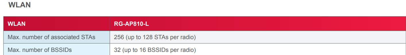

Dear All,
Good day any of you had been using the Ruijie RG-AP810-L ? how was the Performance ?is good ? I like to know whether it suitable for  Cafe usage for 100 pax Guest Access by using the Ruijie RG-AP810-L or  RG-AP820-L(V2) ? hopefully to get your opinion from all of you all !
Thank you
RG-AP810-l

AP820-L (V3) will be best for for you, yu can cater for 120 max clients. And tge coverage for a range of 30m. Its fastee than th AP810 wch host only a max of 64 ppl and lesser distance coverage.

Dear sir,
Based on your use environment, we suggest that AP820-L(V2) is more suitable for you
AP810-L can support maximum 256 users to connect to ,while AP820-L(V2) can suopport maximum 1024
