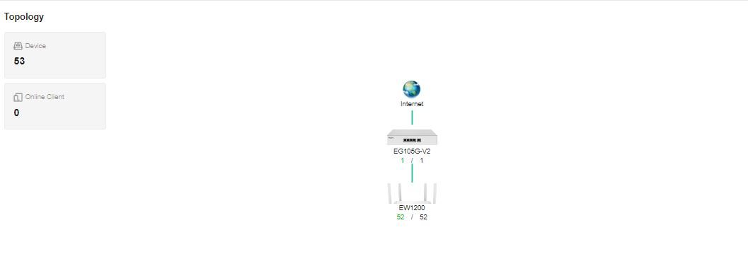

Hi Support
I have setup the following
1. RG-EG105G(Router) x1
2. RG-EW1200(Access Points) x 30
Everything was working 100% for months and after last firmware update
RG-EW1200 wifi stop working. LAN on RG-EW1200 is working 100%, can access internet.
Need help not sure what to do...

3. RG-EW1200 Wifi - I can connect but very very slow. cant even do a speed test. All devices are getting IP's
When I plug in LAN cable to RG-EW1200 it is working 100%
4. RG-EG105G in server room, connecting to network switches in building and in each department is using RG-EW1200
5. Power supply is Power adapter that came with RG-EW1200
Everything was working 100%, after firmware updates problem
