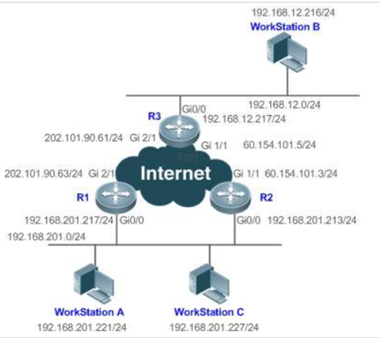

a) Requirement
The cluster of Work Station A and Work Station B (192.168.201.0/24) uses the virtual IP address 192.168.201.1of the VRRP group constituted by the routers R1 and R2asthe gateway address to communicate with Work Station B (192.168.12.0 /24).
GigabitEthernet 2/1on R1 is configured as the tracked interface.
No VRRP but an ordinary routing function is configured on R3.
b) Network Topology
c) Configuration

Verification
Run the show vrrp command to verify the configuration.
Check whether R1, which acts as the Master, reduces its VRRP priority from 120 to 90 when GigabitEthernet2/1 connected to the Wide Area Network(WAN) is unavailable. If yes, R2 becomes the Master.
Check whether R1 resumes its VRRP priority from 30 to 120 when GigabitEthernet 2/1 connected to the WAN recovers. If yes, R1 is re-elected as the Master.
