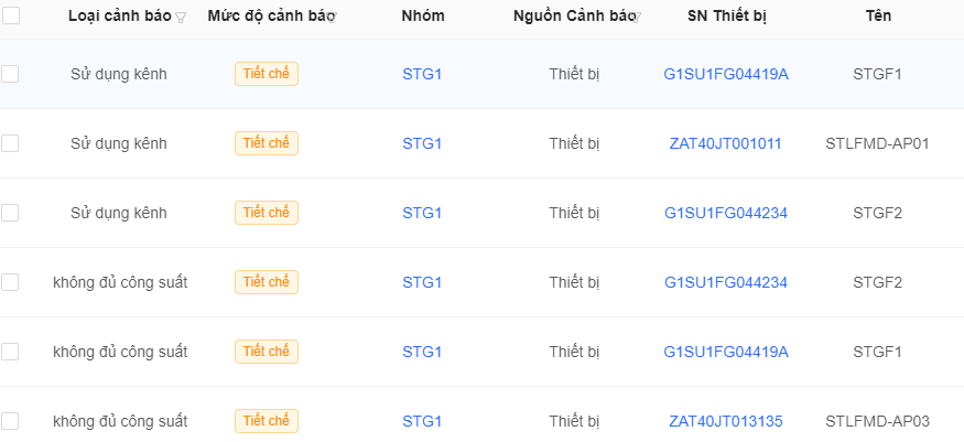

Hello,
The AP device always says it is under capacity, do we need to replace the power source?
RG-RAP2260(G)
0 2024-8-1 14:08:07 View all replies
Hi,Sir/Madam,
The reason for this prompt is that your PoE switch is unable to power up all the APs on the switch due to insufficient power supply. You can test if you still get the same prompt by unplugging some APs and check if the power supply is normal with fewer APs, if the power supply is insufficient due to too many APs, then I suggest you to change to a higher power PoE switch.
