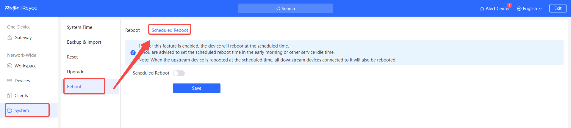

Want to remove scheduled job reboot (ES218GC-P )
0 2024-8-1 19:46:06 Solved View all replies
Hi, suparerk Leadvirai
The ES switch does not support scheduled reboot on itself, however, if it is inside an SON network with other Reyee devices, scheduled reboot can be configured on the SON web interface. You may log into the SON eweb and disable the scheduled reboot. Please refer to the following page:
