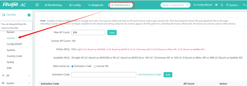

You can Click [Maintenance]-->[License]

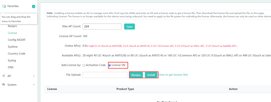

1. import the license to the AC

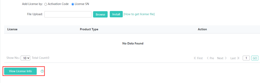

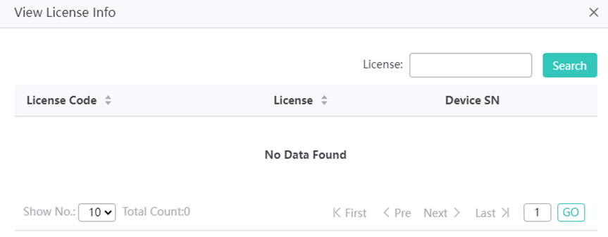

2. Check the information on the license
Note:  Installing a license enables an AC to manage more APs.  First Log into eWeb and enter an SN and a license code to get a license file.  Then download the license file and upload the file on this page.
Unbinding License: The license is no longer available for this device once being unbound.  You need to apply to the PA system to unbinding the license.  Afterward, the license can only be used on other devices.
