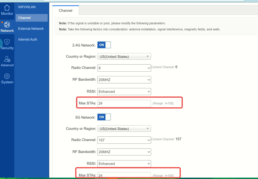

Note: The maximum number of AP that can be connected varies with APs of different models. If you want to connect more users, set the maximum number of AP supported by the actual device. However, we still recommend a better configuration of device recommended connection number, so as to ensure that each customer has a good network experience.

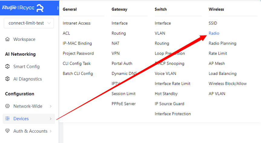

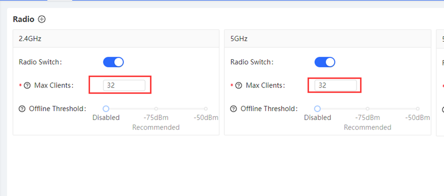

1. For Ruijie AP:
(1) You can check whether you have set up sta limit on the web interface
(2) Check has set up sta limit on the Cloud

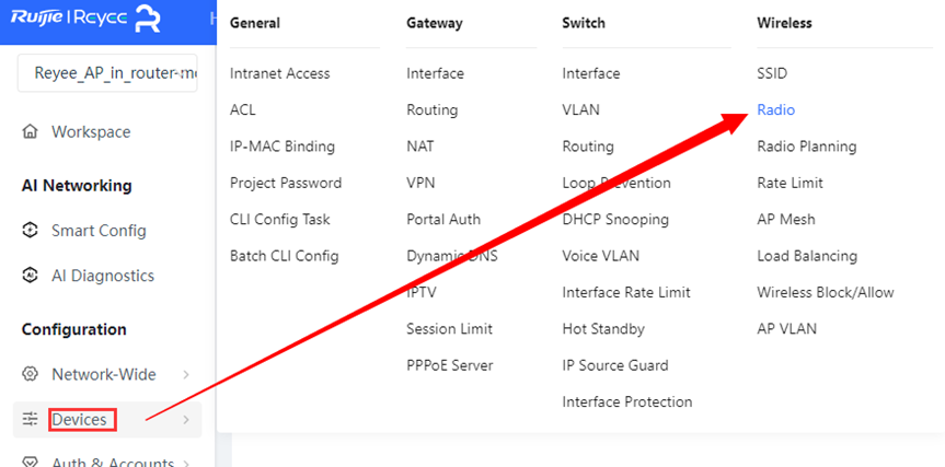

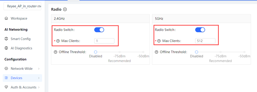

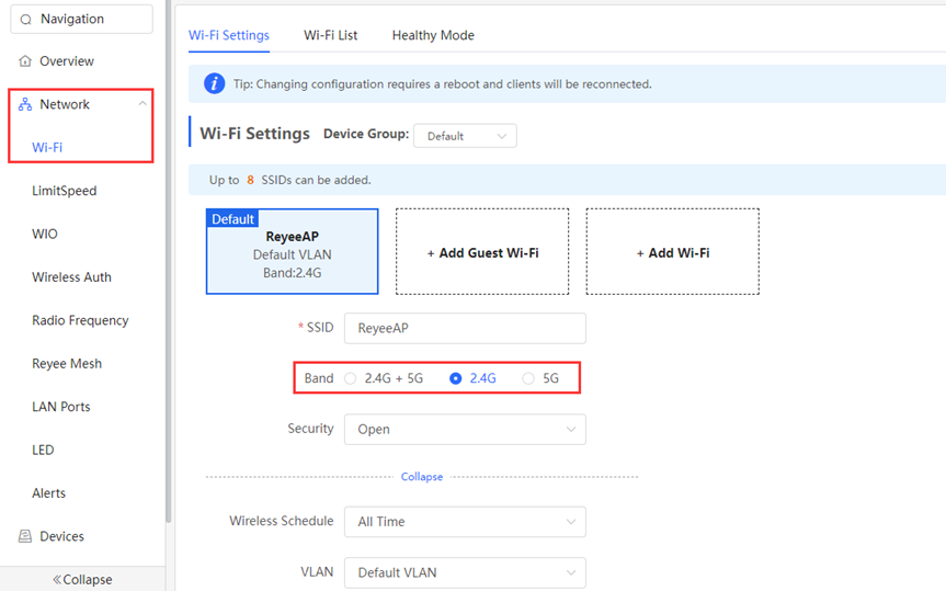

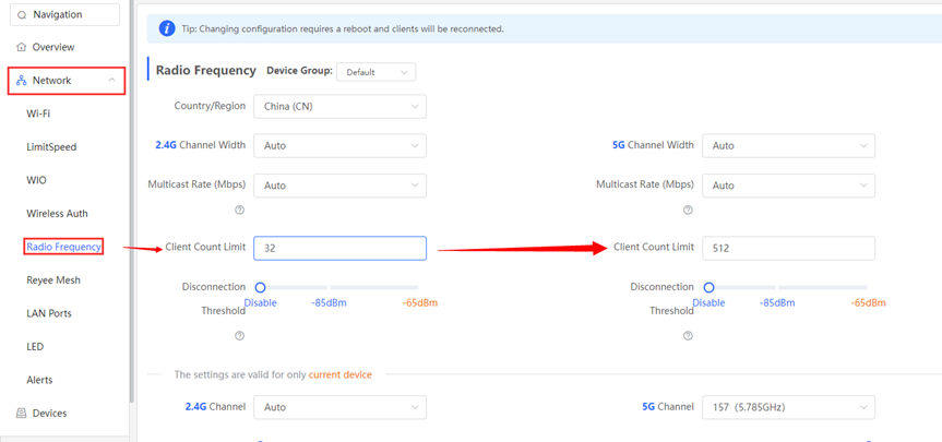

2. For Reyee AP:
(1)You can check whether you have set up a sta limit on the EWeb,What type of radio is being used for the SSID
(2)Check on the Cloud, Whether radio has been enabled and what's the maximum sta can be connected to?
