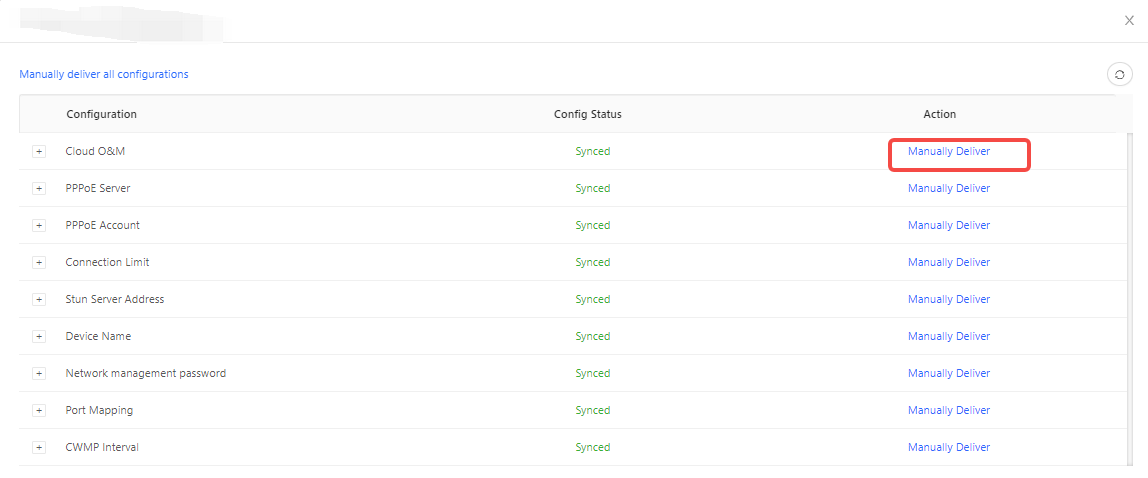

my device is not sync, i'il try to manual deliver, after i klik Manual Deliver, status "Waiting for execution", what is means Waiting for execution, what sould i do

Hi Muhamad Ari Doni Awan,
The status means you need to wait. The process needs time to be synchonized. If it does not work, please try to manual trigger it again or change some parameter of that configurtaion.

how to try to manual trigger it again or change some parameter of that configurtaion, can i do configuration on cloud, or must be on eweb
You can click the sync status to check which configuration is not applied and then manually trigger it. If it still fails, please change some parameters on the cloud of that part.

i was do Manually Deliver but still Not synced
, and my Device  config status is waiting
Is your device online on the cloud? Is it is, then the color is green. If not, please make it online on the cloud first.
How to do when Reyee devices cannot go online on the Ruijie Cloud? - Switch - Ruijie Community (ruijienetworks.com)
If it is online while still cannot sync, please contact service_rj@ruijienetworks.com and share the project with me.
How to share network on cloud? - Ruijie Cloud - Ruijie Community (ruijienetworks.com)

Thanks my problem was solve with GTACJ*yden
