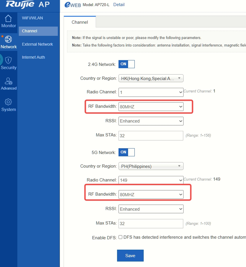

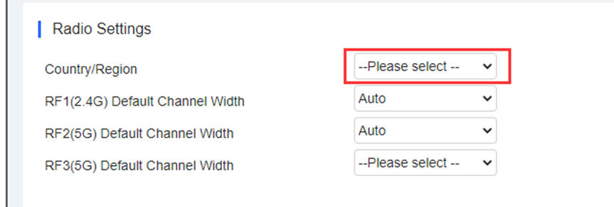

3. Change the channel width on the web interface
RG-AP820-L(V2)
Configuration Wireless
