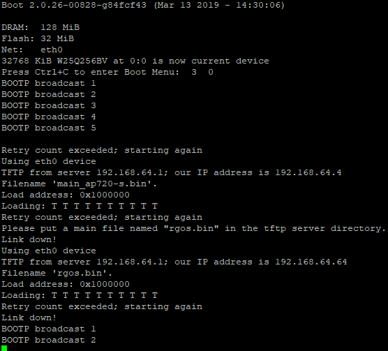

I followed the instructions, but when I connected the console cable and restarted the AP, using Putty (Press Ctrl+C
) to log into the boot, it showed this error.

dang Danh replied at 2025-3-28 10:52
I followed the instructions, but when I connected the console cable and restarted the AP, using Pu ...

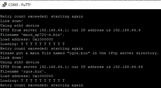

So i don't press Ctrl+C into boot, but i see this notification . Where file "main_ap720-s.bin" and "rgos.bin"?. Maybe you connect my computer by Ultraview or Anydesk support me now, because i'm not IT profesional,i'm student ?
