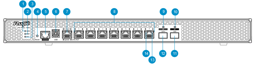

1.1 RG-WALL 1600-Z3200-S Panels
1.1.1 Front Panel
Front Panel
Components on the Front Panel
   No.      Component      Description
  1
  SATA hard  disk status LED (SATA)    Steady green: A hard disk is connected.
  Blinking green: Data is being read or written.
  2
  Power module  status LED (PWR)    Steady green: The power supply is normal.
Off: The power supply is cut off or fails.
  3
  System status  LED (SYS)    Blinking green: The device is powered on and being initialized.
Steady green: Initialization is complete.
Steady red: An alarm is generated.
  4
  Reset  button
  Restarting the device: Press the button for less than 3 seconds.
Restoring factory settings: Press the button for more than 5  seconds.  When you  perform either of the preceding operations, device status information is  collected. After the device restarts, you can access the web UI of the  firewall, choose O&M >
Fault Diagnosis  >
One-Click Collection,  and download the information.
  5
  Console  port
  It is  used to connect to the console for device maintenance and diagnosis.
  Note:
When the console port is used, set the baud rate to 115,200 bps,  data bit to 8, and stop bit to 1, and disable parity check and data flow  control.
The console port is used only  in special scenarios. For details, contact technical support personnel.
  6
  USB port
  Two USB  2.0 ports can be used to connect USB drives.
  7
  MGMT port    It is  used to access the device management page upon first login.
  8
  10/100/1000BASE-T  ports    Ports 1 to 7,  which are used to connect Ethernet cables.
  9
  10GE SFP +  port LED
Steady green: The port is connected.
Blinking green: The port is receiving or sending data.
Off: The optical port is incorrectly connected.
  10
  1GE SFP port  LED
  11
  1GE SFP port    Port 8F. For  details about optical modules that support this port
  12
  10GE SFP+  port    Port 0F. For  details about optical modules that support this port
  13
  Link/ACT  status LEDs (square) of 10/100/1000BASE-T ports
Off: The port is incorrectly connected.
  14
  Speed LEDs  (round) of 10/100/1000BASE-T ports
Steady orange: Gbit/s port speed
Off: 100/10 Mbit/s port speed

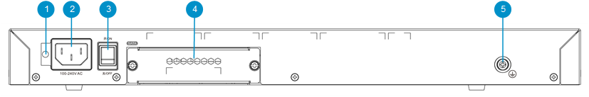

1.1.2 Rear Panel
Rear Panel
Components on the Rear Panel
  1
  Installation  position of a power cord retention clip
  Used to  install a power cord retention clip.
  2
  Power  socket
  Used to  connect an AC power cord.
  3
  Power  switch
  Used to  power on or power off the device.
  4
  Expansion  slot for a hard disk
  Used to  install a hard disk.
  5
  Grounding  terminal
  Used to  ground the device to ensure electrical safety.

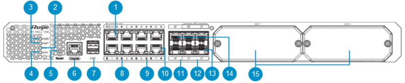

1.2   RG-WALL 1600-Z5100-S Panels
1.2.1   Front Panel
Front Panel
  1    MGMT port    It is used to access the device management page upon first login.
  2    System status LED (SYS)
Blinking green: The device is powered on and being initialized, or  the system is restoring factory settings.
Solid green: Initialization is complete.
Solid red: An alarm is generated.
  3    Power module  status LEDs (PWR0 andSolid green: The power module is operating normally.
Solid red: The power module is not functioning properly, or the  power module is installed but no power cord is connected.
Off: No power supply is connected.
  4    SATA hard disk status LED (SATA)  Solid green: A hard disk is connected.
  5    Reset button  Restarting the device: Press the button for less than 5 seconds.
Restoring factory settings: Press the button for more than 5  seconds.  When you  perform either of the preceding operations, device status information is  collected. After the device starts, you can log in to the web UI of the  firewall, choose O&M  >
Fault Diagnosis > One-Click  Collection, and download device status  information.
  6    Console port    It is used to  connect to the console for maintenance and diagnosis.  Note:
  7    USB port    Two USB 2.0  ports can be used to connect USB flash drives.
  8    Link/ACT  status LEDs (square) of 10/100/1000BASE-T ports  Solid green: The link on the port is Up.
Off: No link is established on the port.
  9    Speed LEDs  (round) of 10/100/1000BASE-T ports  Solid orange: Gbps port speed
Off: 100/10 Mbps port speed
  10    10/100/1000BASE-T  ports    Ports 1 to 7,  which are used to connect Ethernet cables.
  11    1GE SFP port  LEDs  Solid green: The port is connected.
  12    10GE SFP +  port LEDs  Solid green: The port is connected.
  13    10GE SFP+ ports    Ports 0F to 3F
  14    1GE SFP ports    Ports 8F and 9F
  15    Module slots    Expansion module slots

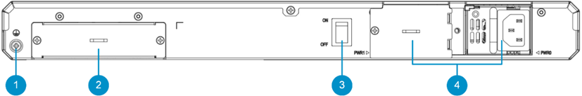

Rear Panel
   No.      Item      Description
  1    Grounding  terminal    Used to  ground the device to ensure electrical safety.
  2    Hard disk  slot    Used to  install a hard disk.
  3    Powerswitch    Used to power  on or power off the device.
  4    Power module    Used to  connect an AC power cord. Two power modules can be installed.
