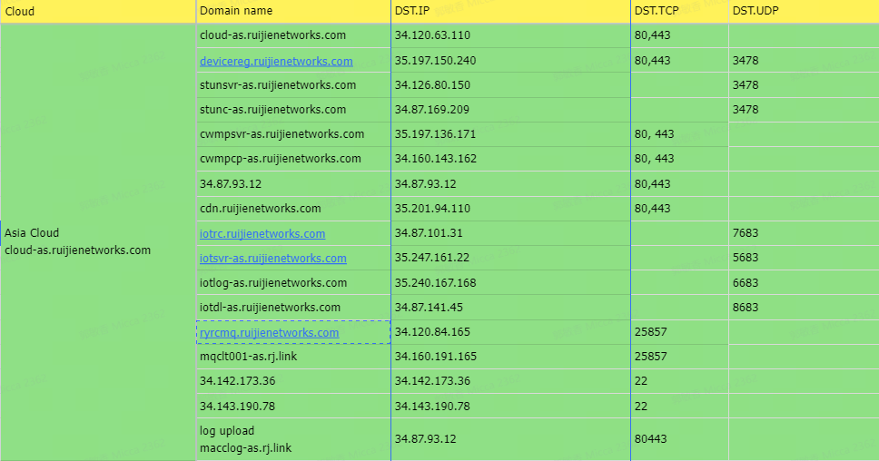

     3)  Following ports are used for Ruijie Cloud management. Ensure these ports are available and the data stream is permitted.
Ruijie Cloud Server IP and Port-public-20250821 update
Note: AP and SMB switch have default CWMP setting which allows devices can look for Ruijie Cloud automatically. But for enterprise switch(RG-S29 series), It needs to configure CWMP URL on CLI manually.
