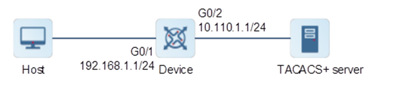

Requirements
1. Accounting for the operation of logging in and exiting the device
2. Accounting for the operation commands of the logged in user
Topology:
Configuration
