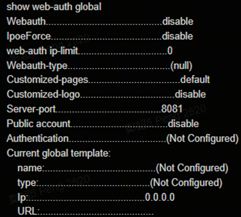

The following figure shows that web authentication is disabled.

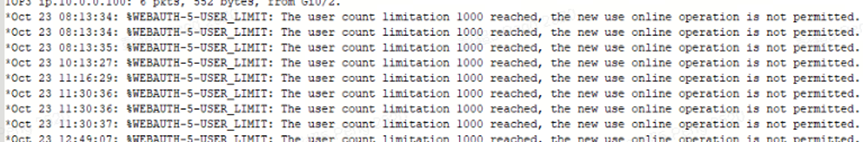

The log shows that the web authentication module constantly reports that the numberof users exceeds the limit.

Verify the web authentication configuration to check if web authentication is enabled.

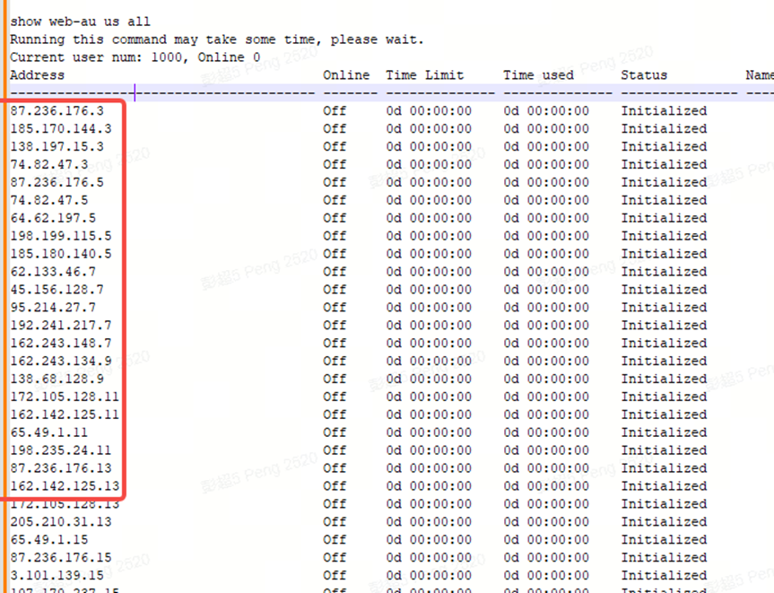

2. Verify the information ofauthenticated users.
It is found that a significant number of authenticated users are in an initialstate, most of which use public IP addresses. It’s suspected that theauthentication port is opened, and is facing an attack from a public network.

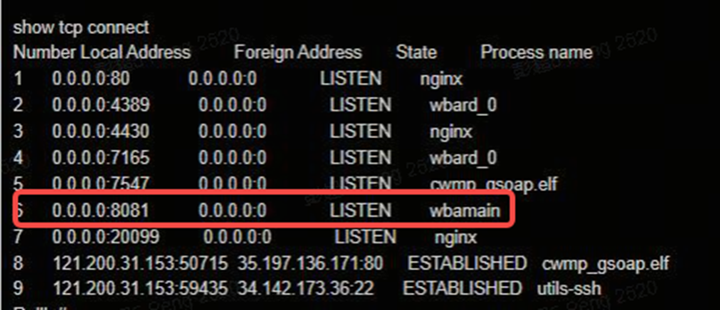

3.Verify the authentication port number.
TCP port 8081 is the authentication port and is opened. It is suspected that TCP port 8081 has been opened due to certain configurations.

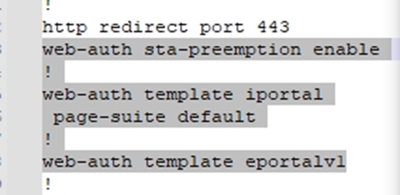

4. Verify the configuration file.
The following web authentication configurations are found.

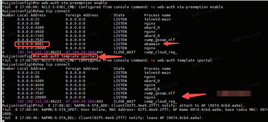

5. Remove the web authentication configurations and check the port status again.
After the no web-auth template iportal command is executed, port 8081 isclosed. Further more, no new alarms regarding users exceeding limits are generated.
