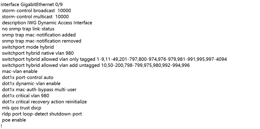

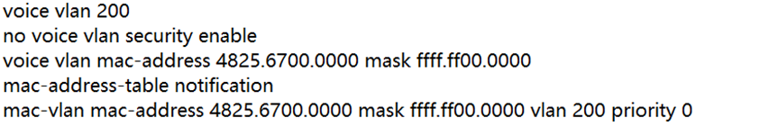

A telephone was connected to a CS83 switch and a voice VLAN was configured. The port where the telephone is connected was set as a hybrid port, allowing traffic from the voice VLAN to pass through untagged. Additionally, 802.1X authentication and dynamic VLAN were enabled on the port. The telephone successfully authenticated but failed to obtain an IP address.

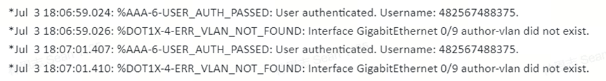

The show log output displays that no dynamic VLAN exists on the port.

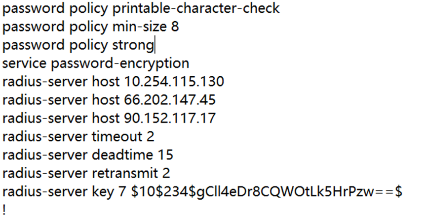

1.Check the voice VLAN, RADIUS, and port configurations on the CS83 switch.
The logs show successful authentication of the telephone, suggesting that the RADIUS configuration is correct. The issue is likely related to either thedynamic VLAN or the voice VLAN configuration.

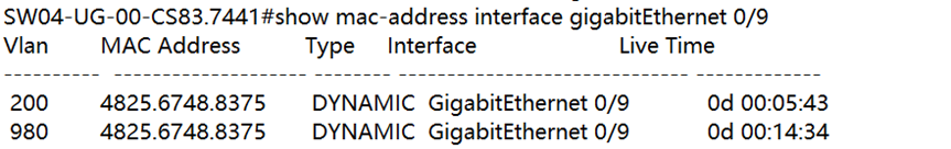

The port enabled with 802.1X can successfully learn the MAC address of the telephone.

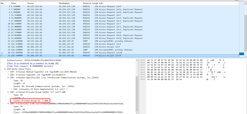

3.Verify the configuration on the RADIUS server and perform packet obtaining andanalysis.
Packets obtained from the RADIUS server show that the AVP (81) Tunnel-Private-Group-Idin the AVPs field is set to T:200.
Cause Analysis
Anincorrect dynamic VLAN value delivered by the RADIUS server prevents the switchfrom properly parsing the VLAN.

The value should be the dynamic VLAN ID or VLAN name. However, because the value contains characters, it is parsed as a VLAN name. No VLAN named T:200 existslocally on the switch. Therefore, traffic from the dynamic VLAN is not permitted on the port.

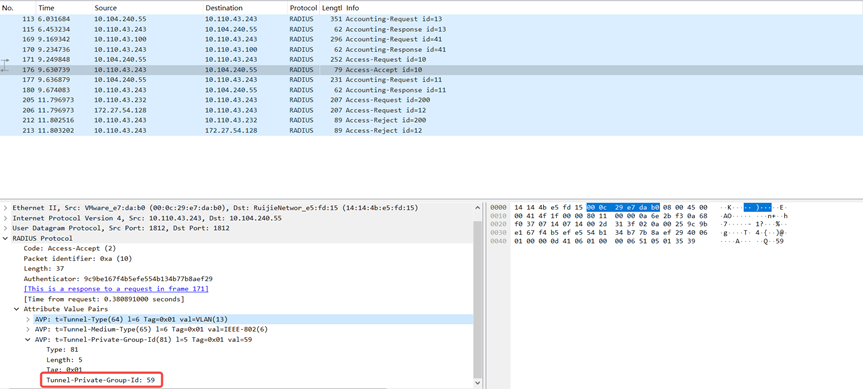

Note:The following figures show RADIUS packets with a VLAN ID delivered normally.
