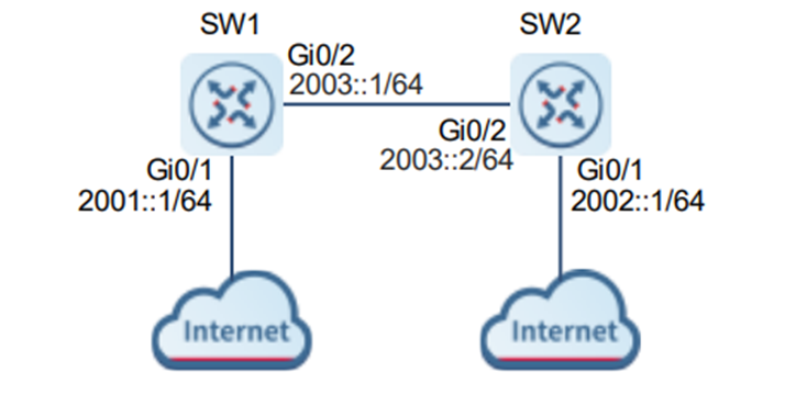

Introduction:
Static routes are manually configured by the network administrator. After astatic route is configured, a static route is generated in the routing table. Static routes are used to forward packets destined for the remote network. On a simple network, you can manually configure IPv6 static routes to implement network communication.
Topology:
Configuration steps:

(3) Configure a static route on SW1 to forward the packets whose destinationaddress is 2002::/64 to 2003::2/64.
SW1(config)# ipv6 route 2002::/64 2003::2
(4) Configure a static route on SW2 to forward the packets whose destinationaddress is 2001::/64 to 2003::1/64.
SW2(config)# ipv6 route 2001::/64 2003::1
