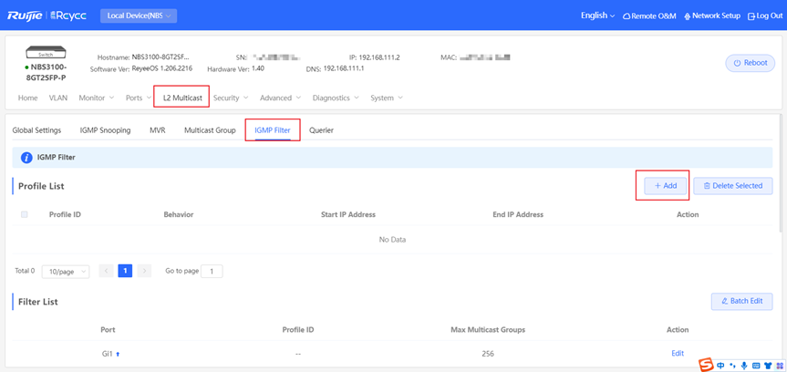

How to configure IGMP Filter on NBS Series switch? Reply
2350 0 2023-8-7 09:38:35

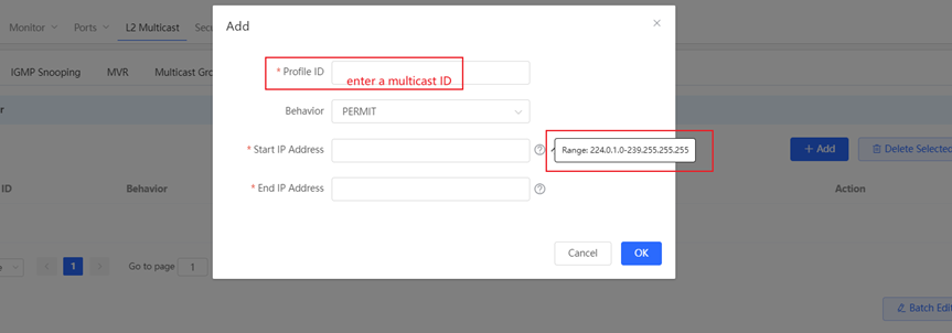

When configuring a port filter, you can cite a profile to define the range of multicast group addresses that can be or can not be demanded by users on a port.
Notice: Maximum number of multicast groups that a port can join is 256.
VLAN filters are not supported
