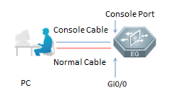

1. Ensure you connect to the Ruijie EG in the following steps

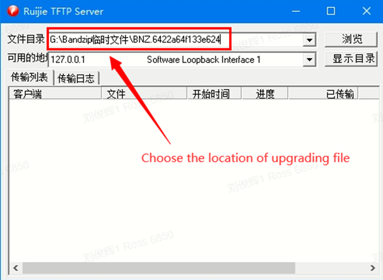

3. Change file name as ‘rgos.bin’, run TFTP server, and choose file location.

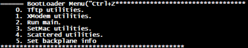

4. Open PUTTY, turn off power then turn on. Input ‘CTRL+C’ in PUTTY consecutively until the following menu appears
5. Input ‘0’ behind the prompt ‘Press a key to run the command’.

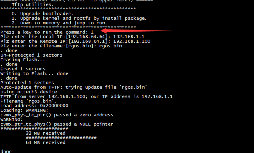

6. Then input ‘1’ behind the prompt ‘Press a key to run the command’. Input ‘y’ behind the prompt ‘Determined to upgrade?’ .
7. Press ‘CTRL+Z‘back to the upper menu. Input ‘2’ behind the prompt ‘Press a key to run the command’ to restart and load the main process.
