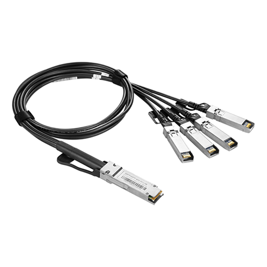

you need command to configure it
Ruijie(config)#split interface + port number
Ruijie(config)#split interface for 1/65
// The 1/65 port is divided into 4 ports for use, and then the purchase of a quarter cable to connect to the interface canbe used for a quarter
After typing this command, you need to save configuration and restart the device for it to take effect:Ruilie# write
Then you need use a quarter cable, there is the example for you

Do we have this quarter cable with the model no?
