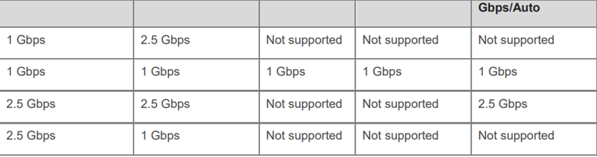

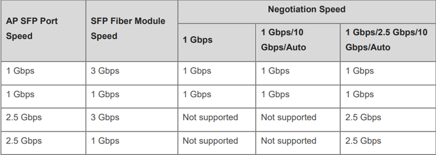

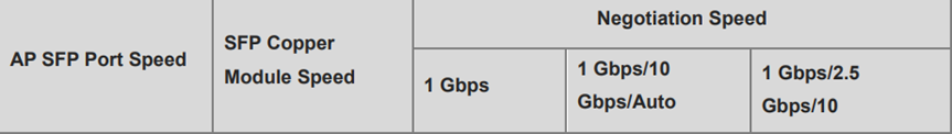

Note:The 2.5G SFP port of the AP supports both copper and fiber links. The negotiation speed may vary with the SFP module type and the speeds on both sides of the link.
Fiber Module: Negotiation Speed When Connected with SFP Port on Peer Device
Copper Module: Negotiation Speed When Connected with Copper Port on Peer Device

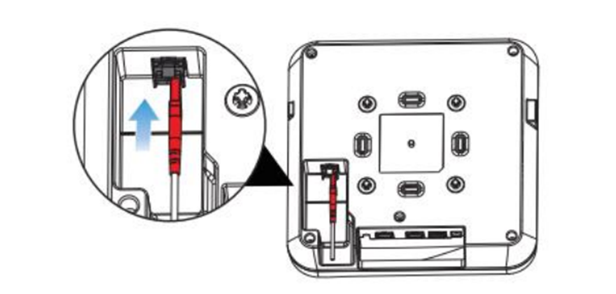

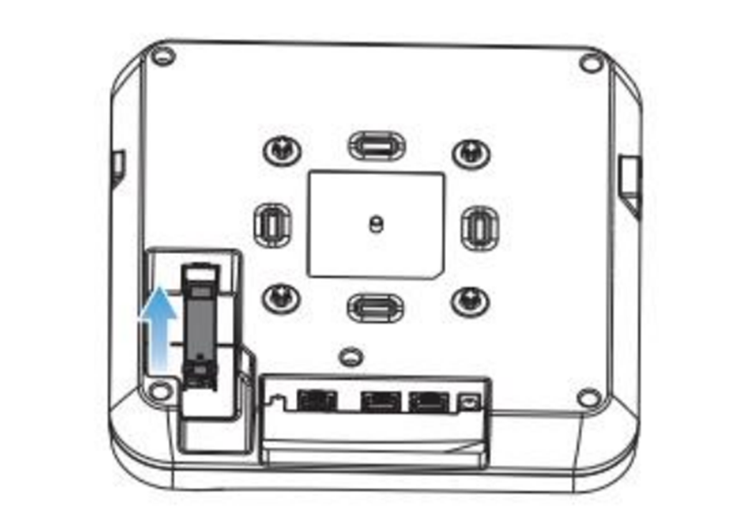

2. Installing the SFP Module
(1)Inserting the SFP Module
(2)Connect the fiber
RG-AP820-L(V2)
