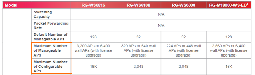

What is the difference between Max number of managemable AP vs Max number of configurable APs?
2988 0 2023-8-4 13:50:42
Maximum Number of Configurable APs: refers to how many APs can be in the AP list on the AC, including offline/online/manually added, corresponding to the number of ap-configs that can be created on the AC
Maximum Number of Manageable APs: refers to the number of online APs that the AC can manage simultaneously
