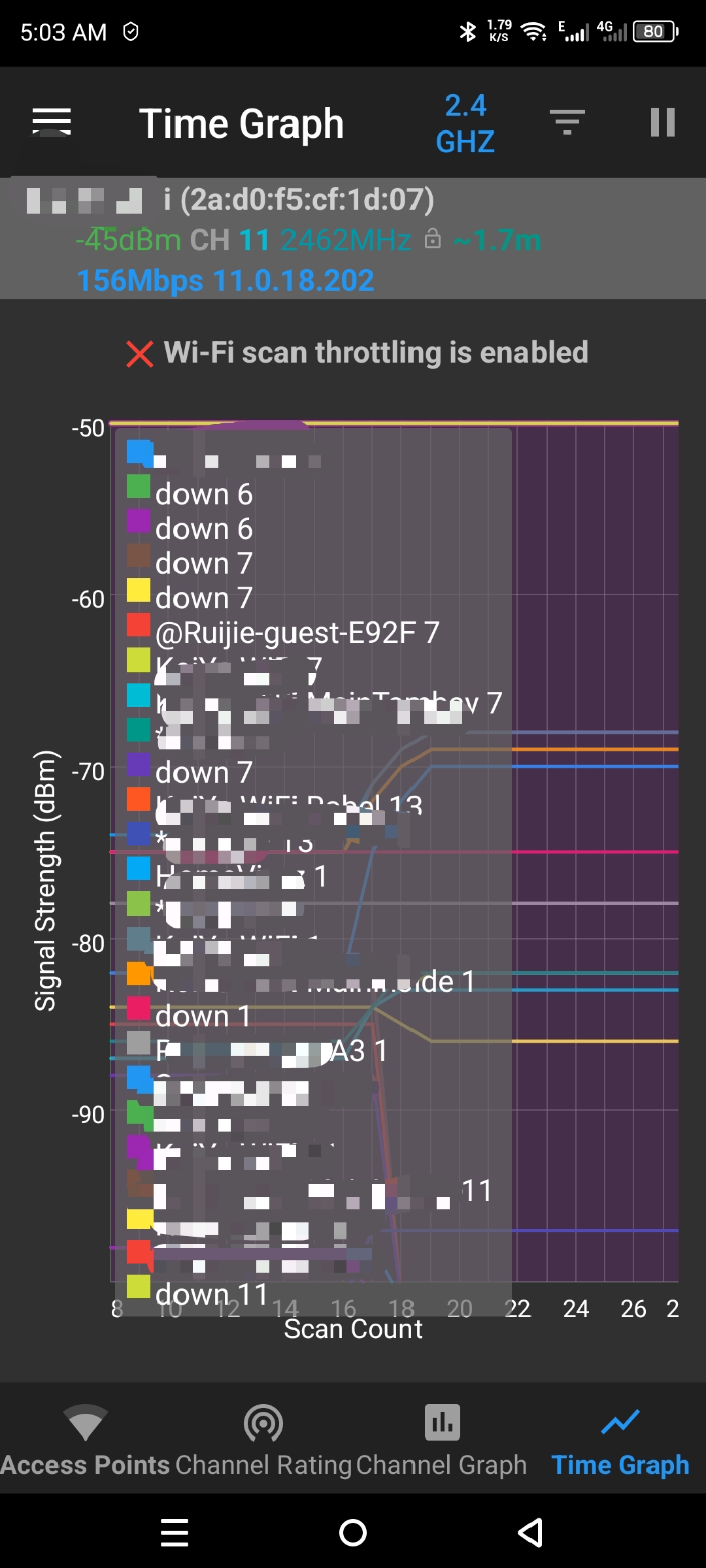

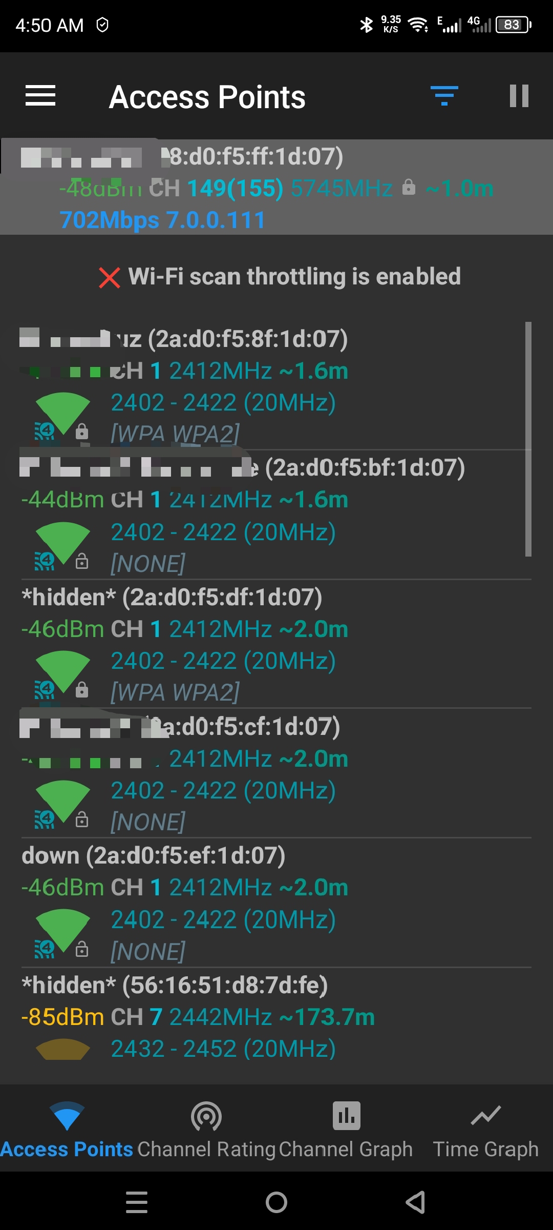

After i update my router all my ap's have down ssid but when i go ssid settings i don't see the down ssid
RG-RAP2200(E)

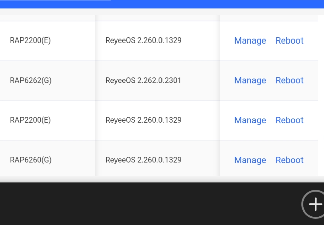

0 2024-2-16 12:06:35 View all replies
AnaKarenDuranUrrutia replied at 2024-2-16 06:52
Dear,
Good  day.
Can I  know what the model of the router is and what firmwware version it has?
RAP6202(G) ReyeeOS 2.260.0.1329
RAP2200(E) ReyeeOS 2.260.0.1329
RAP6262(G) ReyeeOS 2.262.0.2301
RAP6260(G) ReyeeOS 2.260.0.1329
ReyeeOS2.260.0.1329_AP_3.0_1_B11P260,Release_11132917

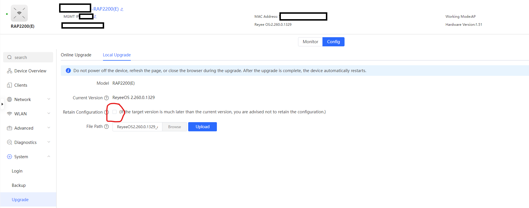

""TO FIX THIS""
you need firmware
ReyeeOS2.262.0.2301_AP_3.0_1_B11P262,Release_10230121
you need manually update it..
then uncheck the retain configuration
