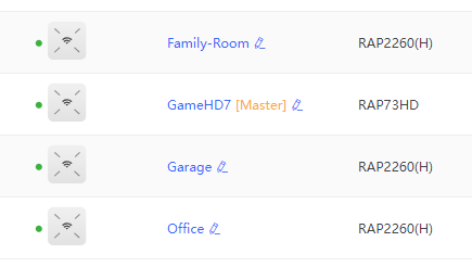

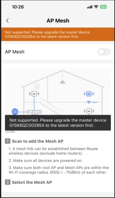

Hello, The network has 1 - RG-RAP73HD and 3 - RG-RAP2260(H) APs, using the mobile app to configure wireless ,mesh for seamless roaming. The mobile says that the RG-RAP73HD which is the master device needs to upgraded to the latest version. The EWEB, Cloud and mobile app shows the RG-RAP73HD has the latest version.

The software version of the RG-RAP73HD is ReyeeOS 2.260.0.1330
