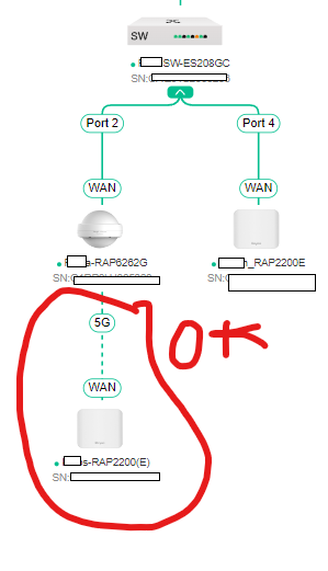

Hello.. i have problem with my RAP6260G connecting SSID with vlan
when i use fiber cable or utp cable i can connect SSID with vlan
but
if i used ""MESH WiFi"" SSID with vlan will get obtaining IP or fail to connect
RG-RAP6260(G)
Wireless Mesh Wi-Fi Troubleshooting Configuration Network Setting

May I know if wireless users cannot get ip or fail to connect, while wired users can connect? If yes, may I know the vlan of SSID? It's vlan 1 or another vlan? How about your topology please?
>Yes
>Yes
>vlan1 connected
>vlan 2 to 4090 obtaining IP
0 2024-3-5 16:38:04 View all replies

how come i can connect other RAP product like RAP2200E

Dear sir/madam,
Please check the port 17 of switch. The port should be trunk, and permit all vlans or vlan 1-4090

i already do that
