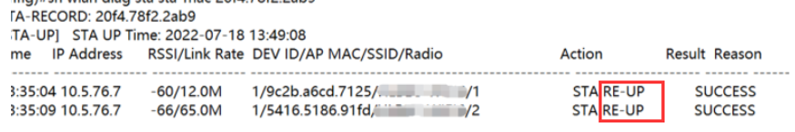

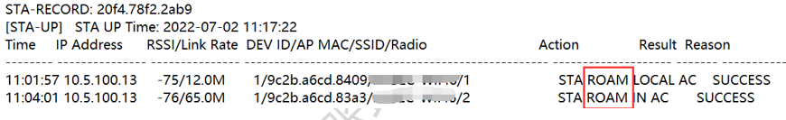

1. show wlan diag sta sta-mac xxxx.xxxx.xxxx
Level 2 roaming
Level 3 roaming
NOTE: By default, theLayer-2 roaming of the AC is not displayed as "roam", and roaming entries are not set up. The roaming table can be enabled by running the "roaming layer2 with-entry" command. This function is not required in some special cases

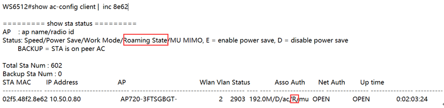

2.
showac-con cli  | inc usermac
