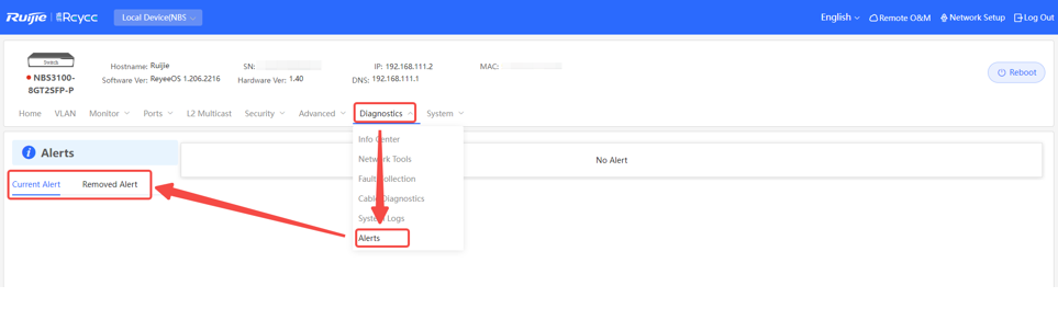

Choose Local Device > Diagnostics > Alerts
Alerts displays possible problems in the network environment to facilitate fault prevention and troubleshooting. You can view the alert occurrence time, port, alert impact, and handling suggestions, and rectify device faults according to handling suggestions. All types of alerts are of concern by default. You can click Unfollow to unfollow this type of alert. The system will no longer display this type of alert. To enable the notification function of a type of alert again, Follow the alert type on the Removed Alert page.
