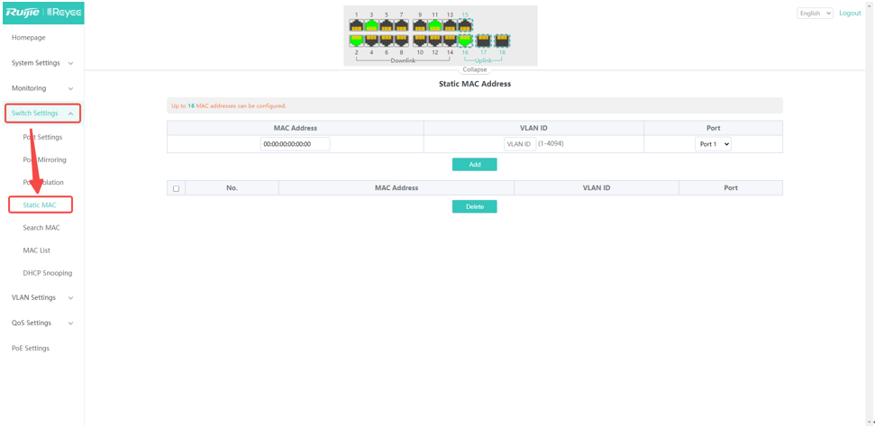

1. Choose Switch Settings > Static MAC.

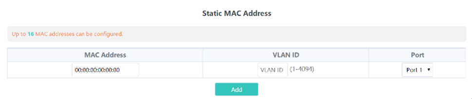

2. Entera MAC address, specify a VLAN ID, and select the outbound port. Then click Add to add a static MAC address. The MAC address entries will be updated accordingly in the MAC address table.

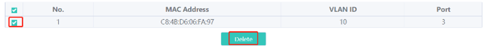

3. If you want to delete a static MAC address, select the MAC address entry you want to delete in the table and click Delete.
