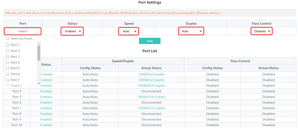

Choose Switch Settings > Port Settings.
Click Selectin the Port column to display options of all device ports. Select the ports you want to configure (users can select multiple ports to set the basic attributes of the Ethernet ports in batch), and then select the port status, port rate, port duplex mode, and flow control status, and click Save.
