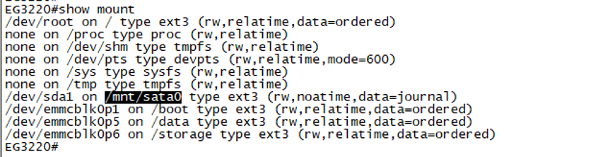

You can check it with the following commands:
Ruijie>enable
Ruijie#show mount
If the '/mnt/sata0' field exists, it means that the hard disk is mounted
